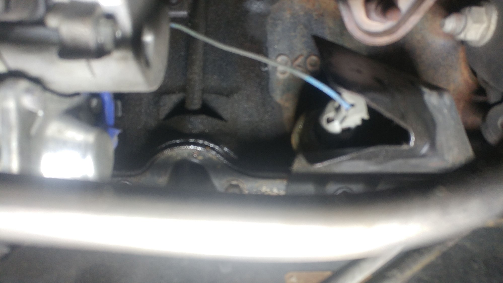

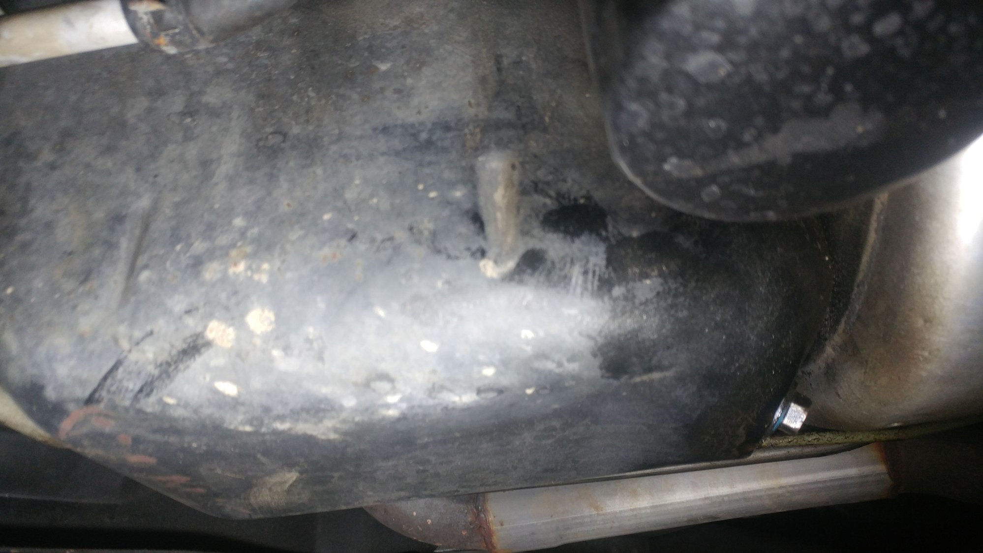

I have a 1990 C4 Convertible. The low oil lit is on in the DIC. The oil pressure and temp gauges are normal. Dip stick shows full. When I bought it the oil light had been removed. I went to two different Chevy dealers and asked for it's location. They both said it's on the side of the oil pan above the drain plug. The print out one of them also shows that to be the location. I noticed that the print said L5. I told the it's a L9. They told me it's in the same place. The oil pan in their print has ridges mine is smooth and my drain plug in the rear of the pan. If any one knows where it's at on this 1990 L98 engine it would be a great help.
Smooth Oil Pan with drain in the rear
Single wire sensor in the engine block above the oil pan forward of the starter motor.

So are you saying that your oil pan has no threaded location for the oil level sensor? If not, then I suspect it's not the original oil pan.

I'm starting to think that. I was hoping someone wit a C4 would tell me that they changed theirs, as they are known to fail, and it was in a certain location. I'm getting a CAT Converter replaced tomorrow and will have it up on a lift. looking under it with a couple of jack stands it's difficult to see much. You would thin if the pan isn't original the connector wold be left hanging or a couple of wires dangling.
