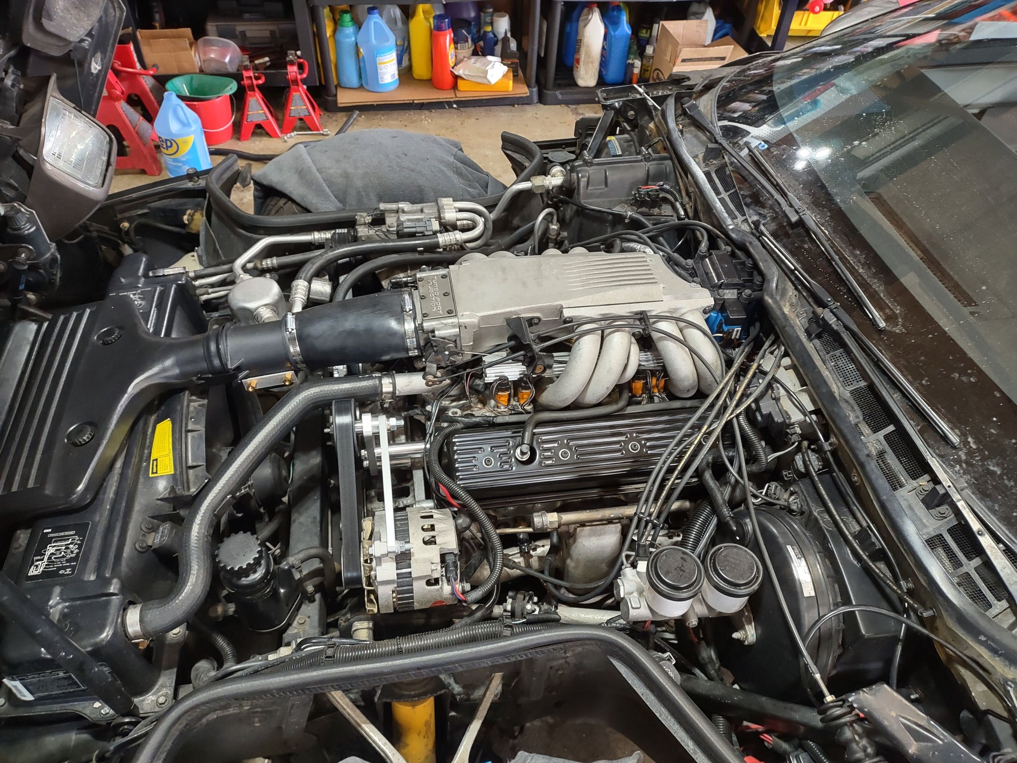

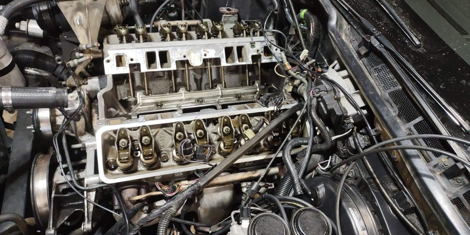

I used to be all Chevy then I fell into the Mustang trap, haha. Been so long since I got to play with a SBC that I forgot more than I ever knew, so this was fun so far. Amazed at how hard it is to get parts that used to be on shelves, but fun. This went quick too. Got it all torn down & cleaned Monday. Intake gaskets didn't arrive till Tuesday at noon & I fired it Wednesday morning.
Dont look too close at how dirty EVERYTHING is, but it is spotless inside. It has 51K on it & I was really doubting it, until I got it open. Just needs aome elbow grease & time & hopefully look as it should.
Monday
Tuesday night
