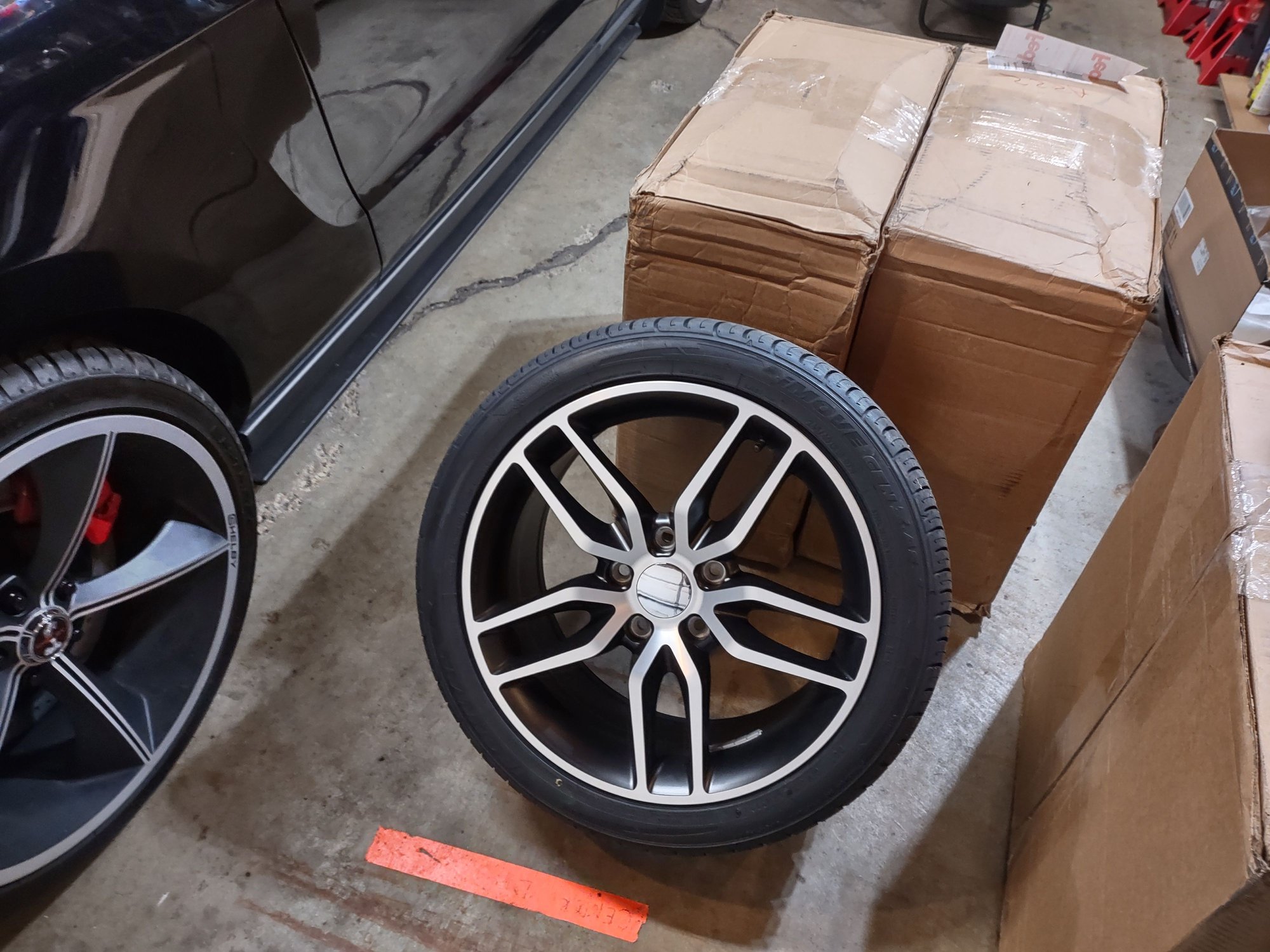

I did find a deal on some new wheels/tires for the Vette, so I'm not that mad at it! They look a little odd in the pic, but much better on the car. Once its going I'll get her all cleaned up & show off some pics

Ya drive it, it does wonders sometimes,it can only get better or worse. the random miss might go away. Good luck, nice wheels.
