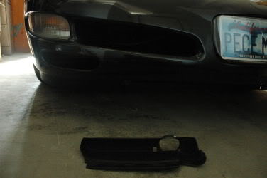

I finally did it! I removed the plastic/rubber that was blocking the fake vents and now my engine runs cooler.
