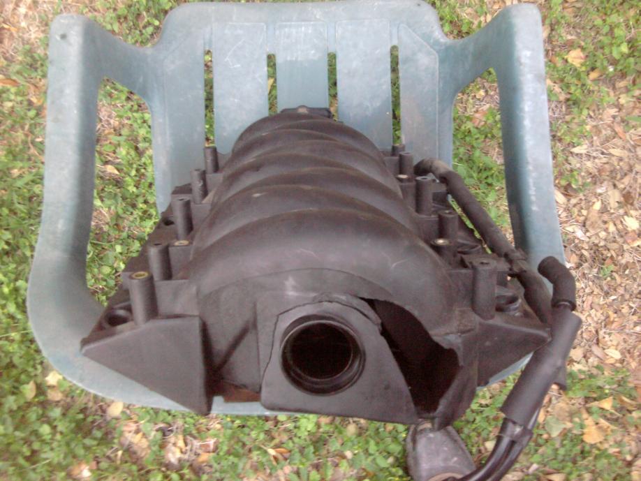

Well my friends seem to think the 100 shot of nitrous I've added about a year ago has something to do with it. It blew the back out of the intake and disconnected the cam sensor and MAP sensors. I didnt use the nitrous every time i was in my car but probably cracked it enough to break this last time.

Here is a pic of the backside of my stock plastic intake manifold.

Whoa! Now that's a serious crack!
