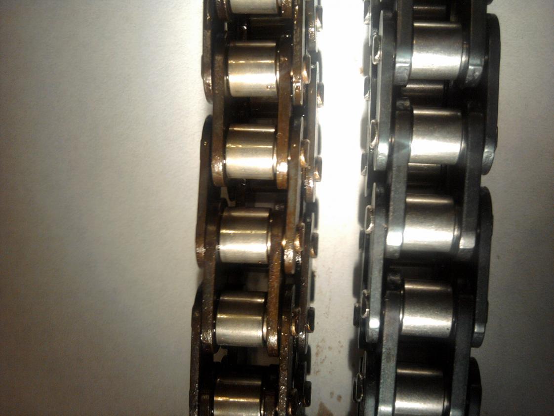

Well I tried to find a puller that could remove the crank sprocket was was unsuccessfull so I decided to go with an LS2 timing chain that is stronger than the LS1.
In the pic the chain on the left is the stock LS1 and the one on the right is the stock LS2 that I installed.
I am currently waiting for some knock sensors and wiring to arrive since I shorted out my original wiring with the replacement intake manifold installation. I think lack of patience caused the short so I will take things slower from now on.
