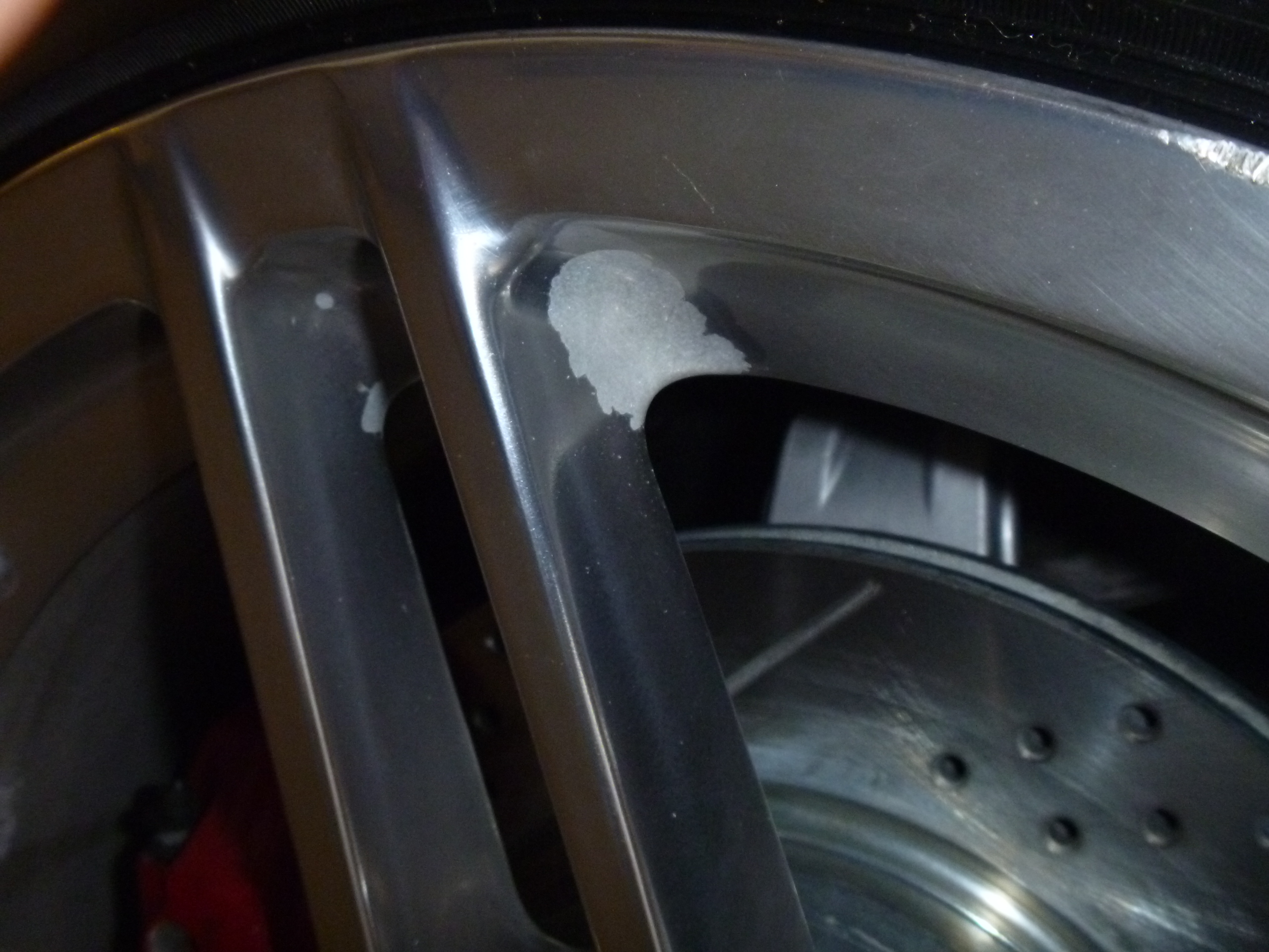

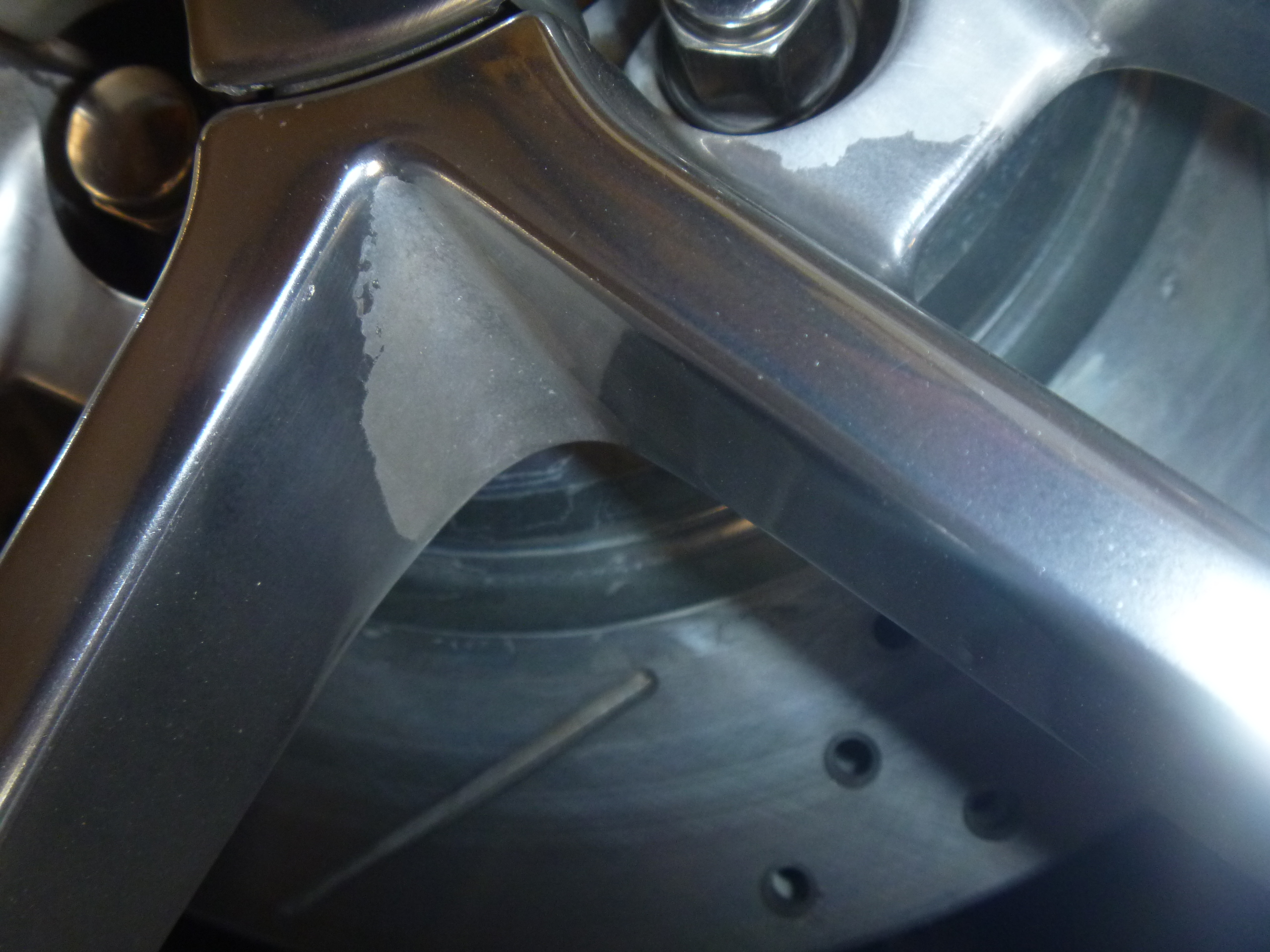

Just moved up to '07 Z06 from my c4 and found a really clean car, low miles car but an issue with a spot on one of the wheels where the shine is gone and a bare spot is there, looks like some corrosive may have gotten it. Would like to clean up and make look better,less obvious. Wondering if there is a paint and clearcoat or similar product for this? Any other ideas?

If they are polished aluminum with clear coat, then the best you can probably do is to repolish those damaged areas and spray some wheel clear coat on them.
If they are painted and clear-coated, then you can prep them, repaint them, and clear coat them.
There are places that do repair damaged aluminum wheels.
