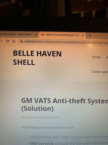

So much for easy fix , the vats control the fuel that could be part of the issue still. Found some information on the vats system it might be helpful.

Thank you Thomas...looked through all 107 pages. Found the VATS section, but nothing that tells me how VATS works with fuel pump, or fuel pump voltage. Going do test shortly with a hot wire from battery to my fuel pump, use harness ground and test voltage. Vice versa...and then see if it will actually turn my pump on.
