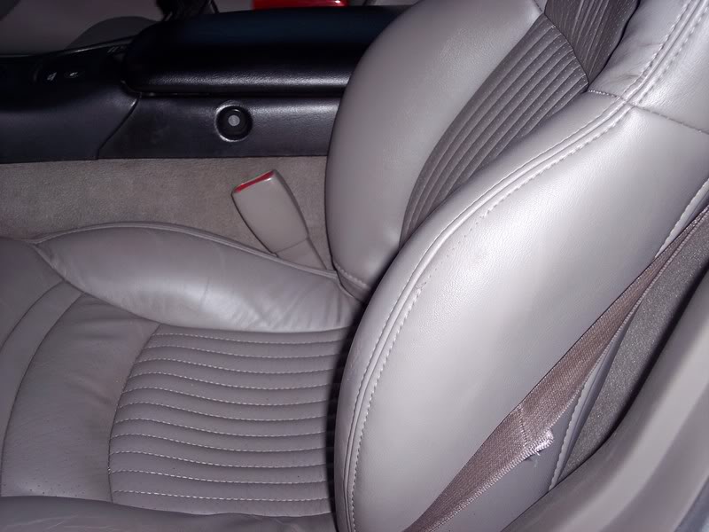

Here are two pictures of what I mean. They show the drivers seat in both my 02 'vette and 04 Porsche. Both cars have right at 20,000 miles on them.
Both seats had side bolsters and a very sporty shape. Note that on the vette, the seam and its thread is at the very crest of the bolster, where, every time I enter or exit the car, my butt and back rub the thread with the result that after 20,000, two places in the seam have opened, one quite wide.
By contrast, while the Porsche has side bolsters every bit as vertical and firm as the 'vette's, Porsche located the seam down and around from the crest, far enough that it gets no friction and rubbed from the dirver entering and exiting; my butt just rubs smooth leather.
This is not a matter of engineering (I assume both seams are designed suitably strong). It is a matter of design. Putting the seam at the very crest of the bolster, where it is rubbed every time the driver enters and exists, is not as good design as is Porsche's, where the seam is pushed back far away from the friction.

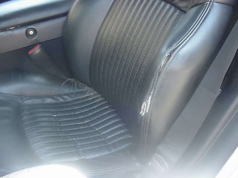

20k miles and that bad huh. Here is mine at 37k miles but I make sure that I don't rub up against the side. The wear that is there was there before I purchased the car. That is worse than my 14 year old nissans leather seats, wow.
