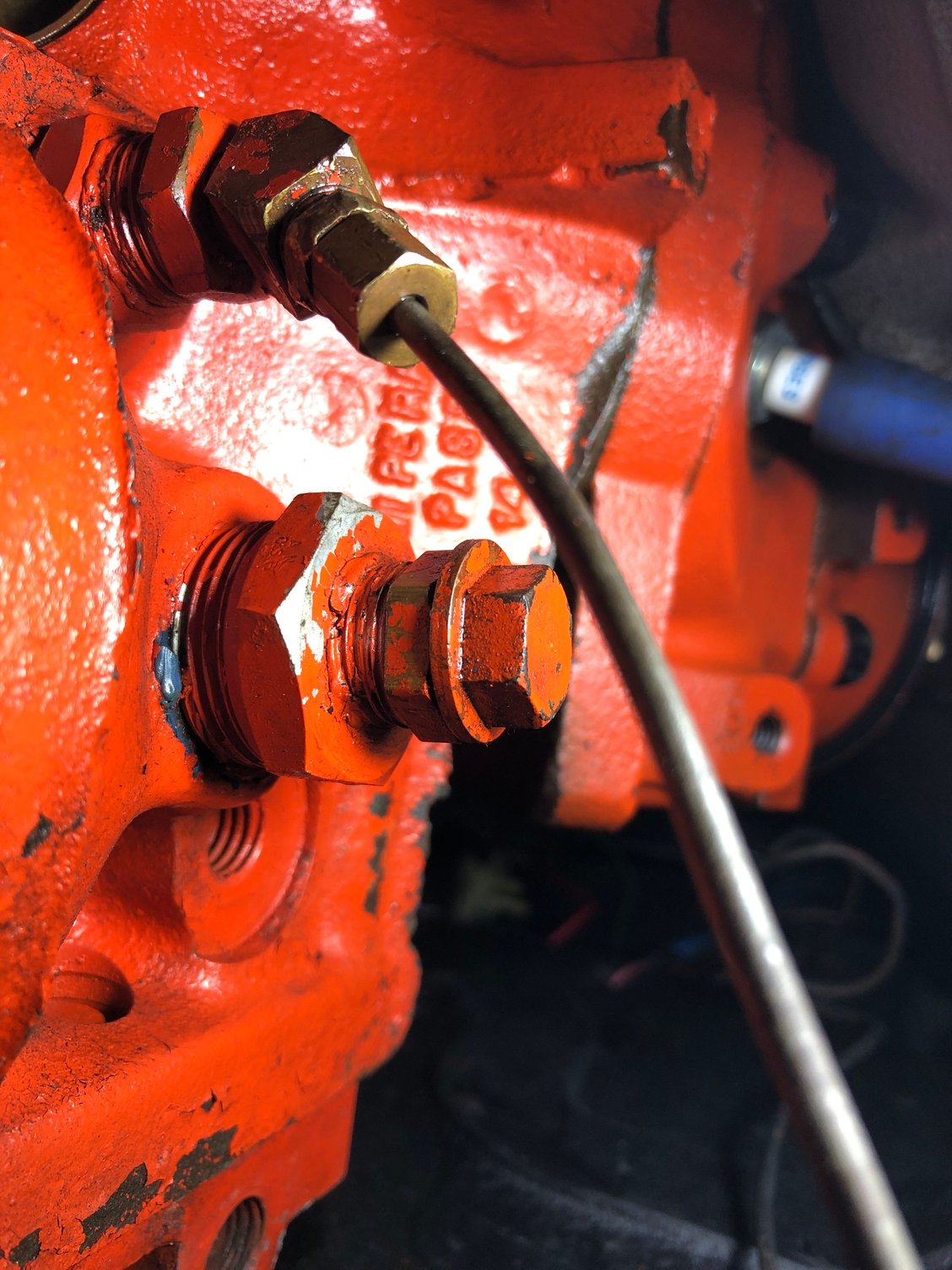

Hi I am new to this Forum I live in the UK i have just purchased a 67 427 corvette numbers matching car but having a problem with the numbers on the car it has a tri power set up on it the numbers i have are as followed engine no on front pad and on tag under glove box 714 IL 7102449 on the block by Bell housing casting 0904351 I dropped the pan and it has 4 bolt mains it has the HI PERF casting on block and has the plug for the oil cooler by the oil gauge pipe by the oil filter 80lb oil gauge 6500 tac what i ham confused about is the IL I thought this was for the 390hp car much appreciate the help thanks Keith

Congratulations on your Purchase. And Welcome to the forums. The block casting number is likely to be a 67 427 (2 or 4 bolt main) number #39044351, the 0 in front of the 9 is likely a 3. lt's hard to read sometimes. Often times when engines are torn down and machined, they deck the bock and grind the numbers off, a sad consequence when numbers matter. The 1L refers to 1-Coupe and L-Built in St. Louis. Standard engine was a 300-hp 327-cu.in. v8. No mention of the 427 option in the serial number, Which seams odd but maybe that was normal for that year of a C-2. I might need to check on that.

thanks for the reply sorry i should have said the car is a convertible the engine has not been Decked still has the broach marks across the numbers on the engine pad it has 4 bolt mains see pictures

Good pictures. Breaking down the engine numbers 714 are casting numbers, The IL suffix code typically indicates the engine configuration 427 and the L36 variant which produced 390 HP in which 5,000 were produced. There's a lot of information out there if you want to know more. And yes that is a engine matching number. I would say it's a keeper.

Hi Thomas just got some paint stripper on the number on the block it is a 3 but on this web site many people say 390hp cars don't have 4 bolt mains and they don't have the oil cooler plug by the oil filter witch this one does thanks Keith

Well it looks like it's the L71 variant 435HP. Nice.
