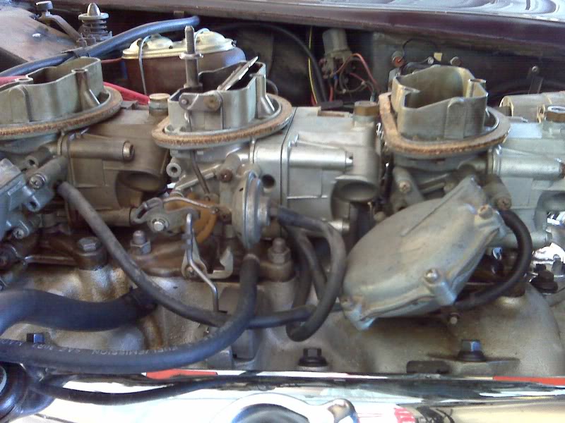

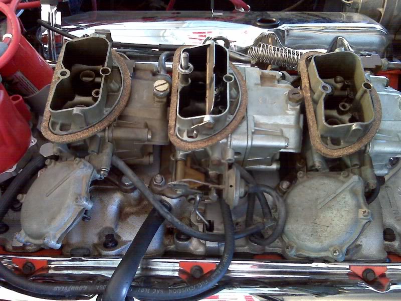

Here are a couple images of the situation

Old Sep 11, 2008 | 07:41 PM
Default RE: 427 Tri-Power vacuum ?
Are you sure you're getting direct vacuum from the intake manifold? Not sure the engine would run w/ only 2 inches of vacuum. I know the end carbs start to open as the vacuum decreases so they might be a source of manifold vacuum. If you truly have only 2" at idle, then the end carbs would be almost wide open.
