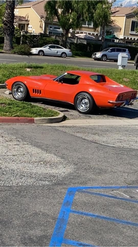

I have a 69 coupe, 84,000 mile car. All original. Exhaust is gonna need to be replaced. Thinking of maybe swapping in headers and ceramic coating them to cut down on the heat coming up through the floor. Car has a 350 and a 4 speed with AC. Who makes a GOOD fitting header for this that doesn’t hang down to much?

I had real good results with Heddman ceramic coated headers . Fit great with no interference with the PS or AC. They were on a 79’ with a 350 block. I purchased them from Summit Racing, just enter the car’s information and they’ll give you all the choices. Got luck with your project and thanx for the picture- very nice looking Vette !

Great looking car! Thank you for the picture.
