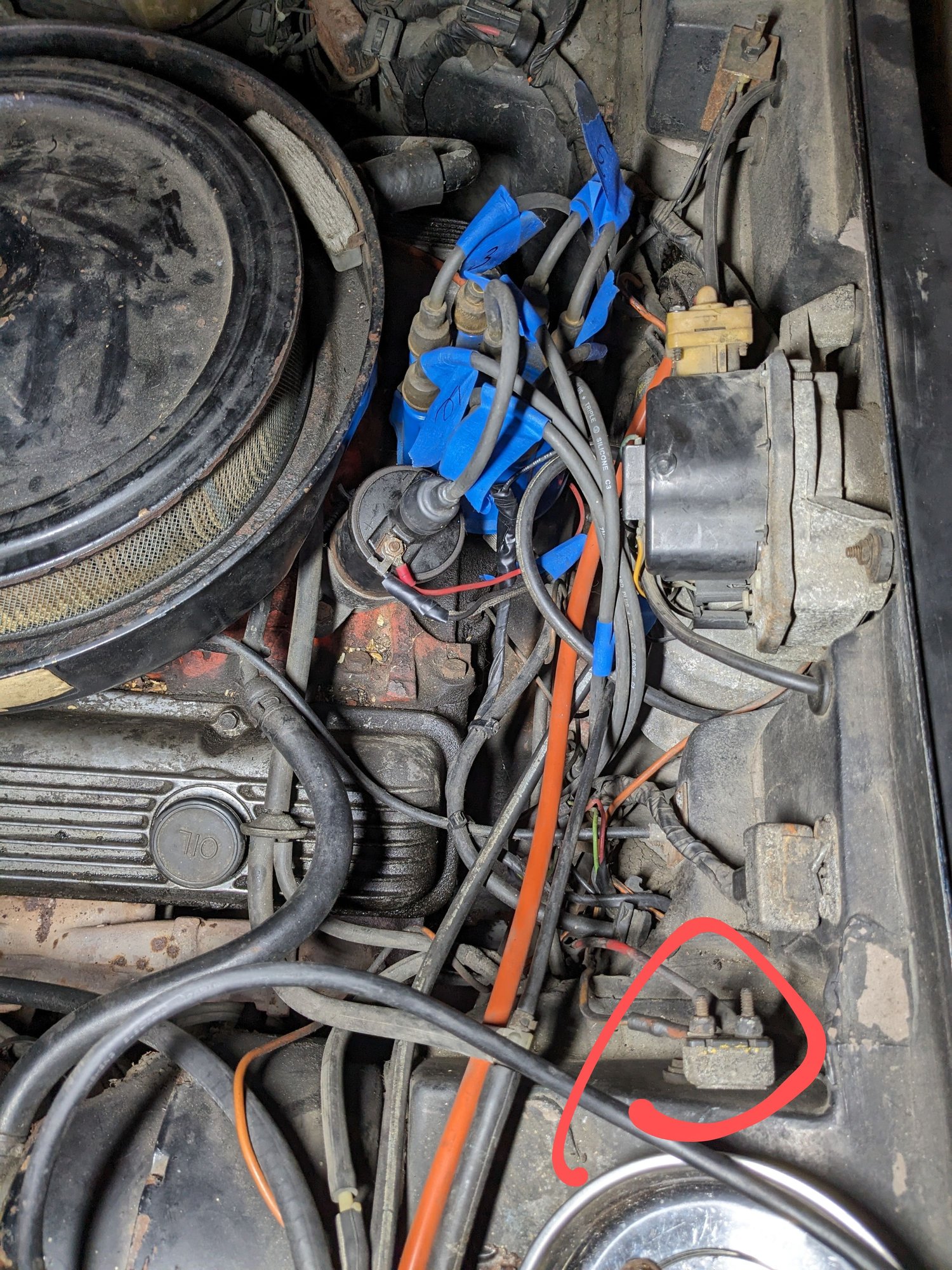

Also, the circled large wire connection is where I can hot wire it from? I assume so but better safe than sorry.

Not sure what the circled red component is but mine has something similar looking mounted on the firewall nearby. It doesn't look like a typical GM relay so I'm wondering if it may be a thermal switch.

I believe that unit is a circuit breaker. You should be able to hotwire it from there.
However, it's also a good idea to check for power at the coil. If the car has been sitting a long time the points may have corroded and you won't have spark. Same issue if the condenser died.
