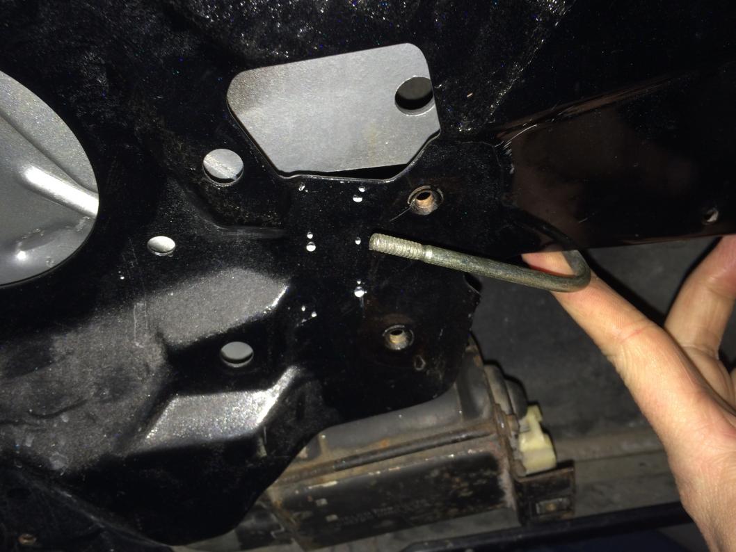

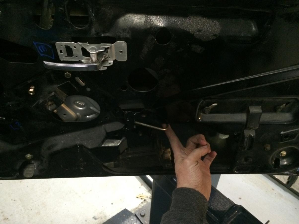

We are here doing a complete rebuild of a 1981 corvette (in Australia), so usual problem of thousands of parts and not enough photos of how things were put together :-0
So I'm stuck on the power locks, I've got it physically working, I'm just stumped as to what this third rod is used for and what it connects to?
Attached Thumbnails Advice for power lock for 1981 corvette?-image.jpg   Advice for power lock for 1981 corvette?-image-1-.jpg

That is the manual door lock rode that the chrome-plastic door lock cap screws to. it goes through the door panel via the hole at 12:00 of the arm rest on both doors. It allows the driver/passenger to manually engage or disengage the door locks, say, in case the battery was dead.
