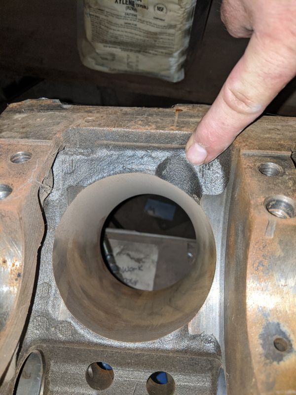

Got some new pictures! This is a 454. The 454block is easy to identify with the pan off because of the cast in relief at the cylinder base. This is for rod bolt clearance, the 454 is just a stroked 427.
Rod bolt relief
