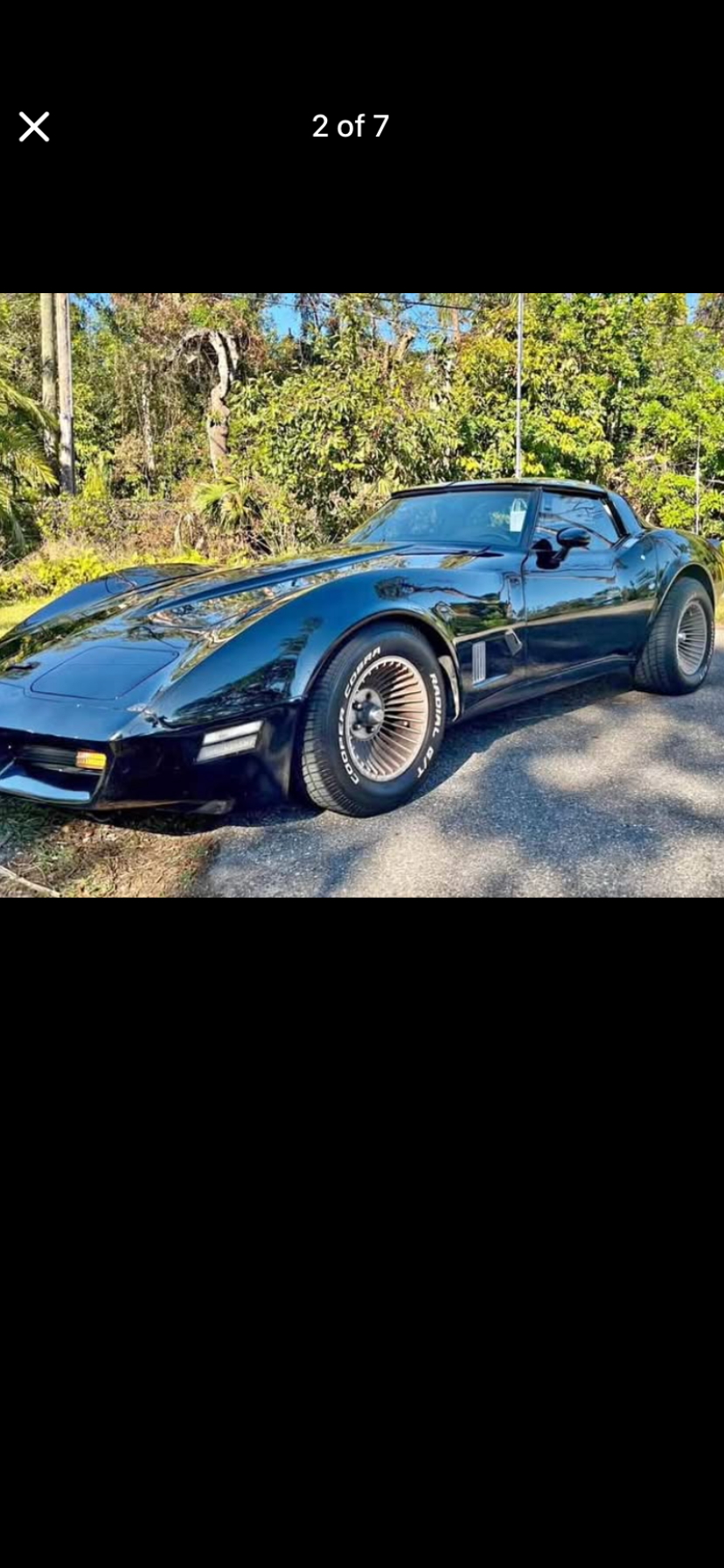

I have a 1981 Corvette C3 and found some transmission fluid below the Trans. Housing area leaking onto the floor. IDK but could it be an O’ring or pump seal. Won’t know until I take it to a mechanic to open it her up. If I need a new transmission what would my best choice be?
1981 Corvette
1981 Corvette
