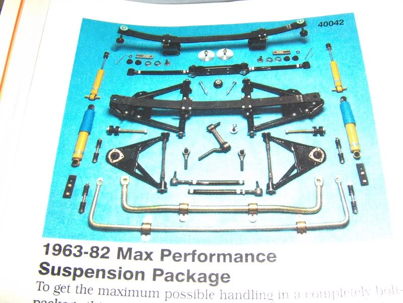

This is the complete suspension package I got from Ecklers in '04.
Doesn't say who builds it.
Got no complaints, really streightens out the twisties.

Old Oct 1, 2007 | 09:43 PM
  #36
allill's Avatar

Hey Jeff,
I showed ya my suspension in the PM, I just put that post up to show to 73shark, thought maybe he knew if Vette Brakes built the system.

Looks like the pic in the Vette Brakes catalog. Thought you said you got it for $749. That's the Vette Brake price for just the front lower A-arms and the monoleaf and hardware. If you got the full meal deal for $749, you got one helluva deal.
The coilovers go for about $525 to $950 depending on whether you get non-adjustable, single, or double adjustable shocks.

The price on the front assembly is 749, the complete system was a little over 2300, which is what I have.
Hey George,
I didn't keep track of hours for the install. It's not really hard per-say, it does take some patience. As mentioned in the ad, no mods required, bolts right in.
I did, replace the complete trailing arm assemblys too. I wanted everything to be new. Rebuilt the diff also.The bolts where the trailing armsmount, were a real b#%@& to get out, at least mine were. A saws-all took care of that.
