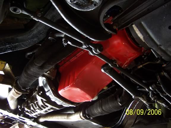

Also, DV8, I noticed an under hood shot of your headers and that you have pretty good ground clearance, anybody got an idea of what those $90 Jegs headers do to ground clearance, I should would love a set of long tube headers.

Old Mar 16, 2008 | 07:53 PM
DeeVeeEight's Avatar
Banned
Joined: Oct 2007
Posts: 594
From: South Jersey
Default RE: Stock manifolds VS headers
Brand of headers - unknown, ground clearance was never a problem, dual hi-flow cats just to keep things legal.
[sm=icon_cheers.gif]
