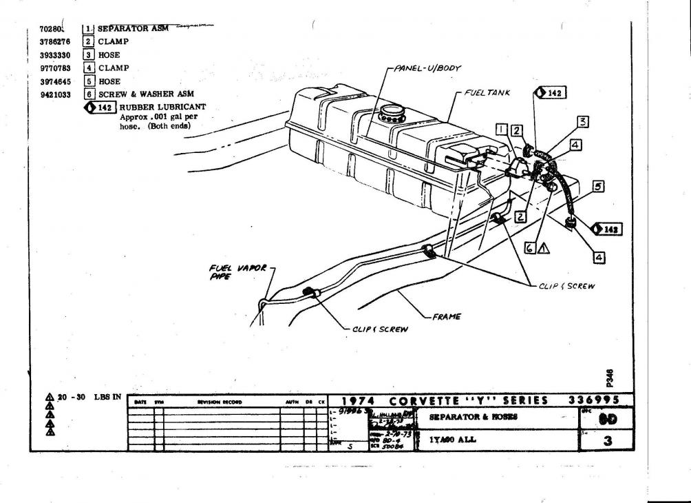

Your right, the vapor separator allows gas vapors to escape the tank (and be absorbed by the charcoal canister) but does not allow raw gas to do the same. There are two rubber lines that connect to the vapor separator, one in and one out. Check those rubber lines for cracks.
Is the gasket on your sealed gas cap good?
There is one more rubber line on the right side of the tank, check that too.
If all thats good follow the hard line on the right side and look where the line goes into the frame, it can chafe there.
Could also be the gasket between the filler and the tank, it could be deteriorating.

Thanks PG! I inspected all the hoses and they all seem to be fine. I'm going to pick up a new cap to see what happens. I like starting with the easiest fix first! If that doesn't do it, I'll climb under while it's running to see if the odor is coming from the valve side first. Should be fun!

I'm 99% sure mine is the vapor separator now. I inspected all the hoses and no leaks. I dropped out the spare tire stuff and all of my astro vents in the back. No leaks anywhere. When running, the strong odor comes from my driver's side rear deck vent and that's right where the separator is. So, I'm replacing it ($50). It's a completely 'blind' repair so it should be a fun one.
