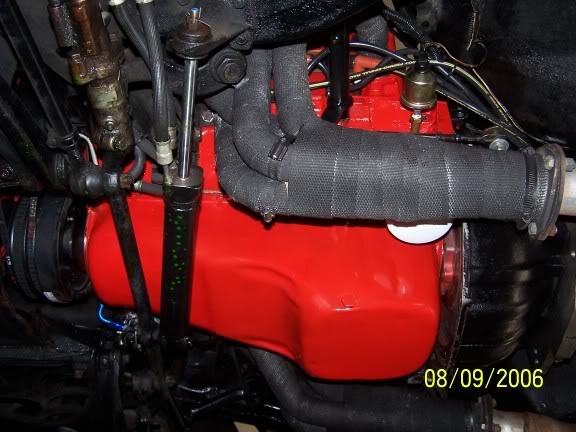

I wrapped my headers, not to pick up power, but to reduce underhood temperatures and thus, cockpit temperatures.
Wrapping headers does keep the heat in, which improves something called scavenging, which in turn gets the hot exhaust gases out more efficiently. You pick up a few ponies this way.
Ceramic coated headers are supposed to improve scavenging by keeping the heat inside of the pipes.
Have you priced a roll of header wrap, and then the high temp. spray paint that goes with it? You just added $100.00 to the cost of your headers!

Hey DV8,
Great pic, BTW!
