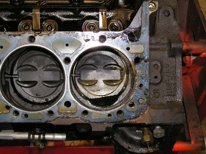

Here's a pic of the coolant sensor:
Usually it's 2 wires - power and ground, on a blade-type connector. Better make sure with you-know-who tho', we dont wanna' start any cerebral anuerysyms. Then you can start trackin' missin' voltage to the sensor, or a bad ground.

okay, first things, first. Where is that pic taken from? is it inside the valve cover? if so, lets talk about intimidation. then let me tell you that i don't know when the fuel filter has been changed either. could this be causing some of the "like crap" running problems? also, i never got a chance to check my plugs or wires. i was also wondering how to check my cap and rotor for correct timing. i see "BTDC" and am thinking this means "something" (B) top dead center. what does the "B" stand for? besides the sensors... could these factors play in the previous discussions?

That pic is with the left cylinder head removed. I see no Coolant Temp sensor. The CTS is in the intake manifold facing forward just below the thermostat housing. It is a 2 wire GM Metripack connector, 1 wire 5v reference, 2nd wire signal return, (Sensor is a reverse thermistor, meaning, the hotter the temp, the lower the voltage return to the ECM)and is grounded through the engine block. BTDC is ignition timing set to spark 4 -6 degrees before the piston reaches top dead center, that is, before it reaches the very top of its stroke.
