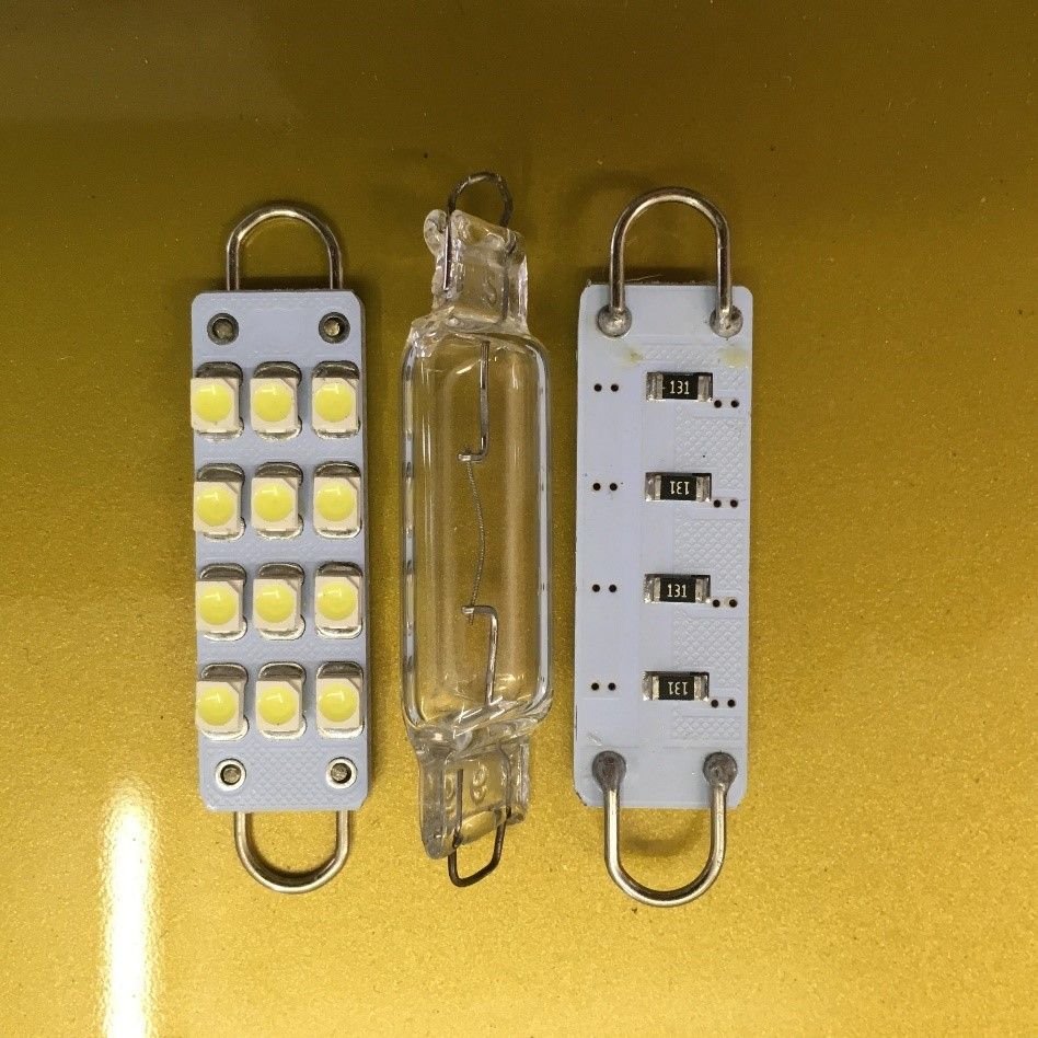

My C4 Convertible uses 5 bulbs of type 562 (loop style).
Two Under dash to light up your feet.
Two in the rear storage area.
One in the center console.
This upgraded to LED was successful. I got what I wanted.
A little more brightness and Less Power/Heat.
The Lumens increase was from 75 to 100.
Original Incandescent #562
Watts: 10 per bulb.
Lumens: 75 per bulb.
LED #562
Watts: Less than 1 watt per bulb.
Lumens: 100 per bulb
Advertised as 400 Lumens for a 4-pack of bulbs.
You must divide the package count into the Lumens to get a more realistic value.

LED on left, cells only on 1 side. Original bulb center.

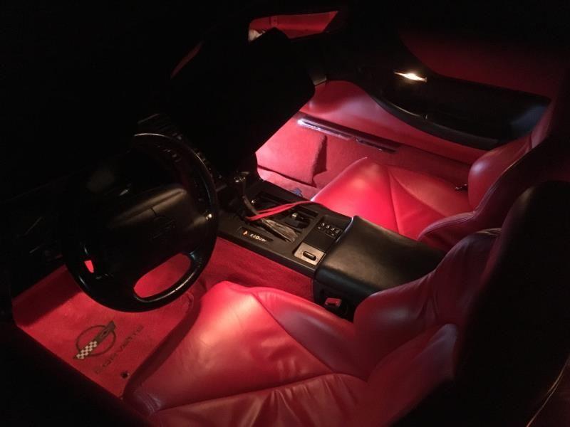

Console Box: This picture was taken without flash or any background lighting using the new LED replacement. It is brighter than the bulb. Under the light cover is a "black" reflector. I painted the reflector "White". I am sorry I do not have a before picture.
Passenger side floor light: If you look closely you may notice the floor of the Passage side is a little brighter than on the Driver side. Only the Passenger side has the LED courtesy like for the floor area. The Driver side is running the stock bulb.
