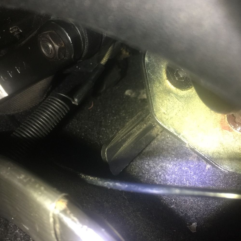

I have had this problem with my '96. There are mechanical levers on each side which you can mechanically release the deck lid. The top needs to be released first of course with the handle that is located on the underside of the decklid near the yellow button electrical release. It is on the drivers' side behind the seat. Once you have the back of the top/window out of the way, you have to go in under the deck lid and find the lever that is located behind where the seat belt comes up and sits. Get a good flashlight and look back under the decklid and out toward the outside of the car. The picture below is the passenger side. The lever on the drivers' side is in the back and harder to see. I think GM used the same part so it is the opposite.
The lever is the horizontal black piece at the bottom of the picture.

This is a picture of the drivers' side.
