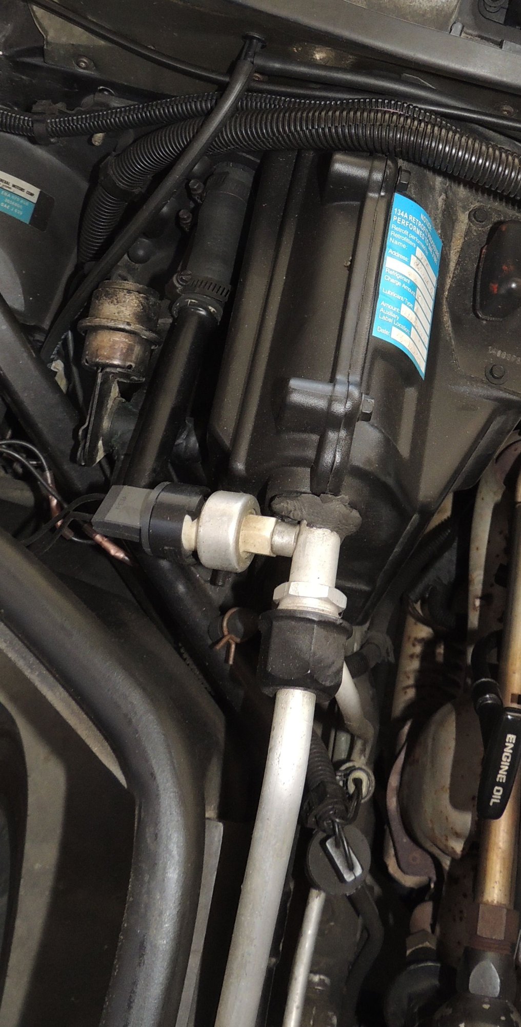

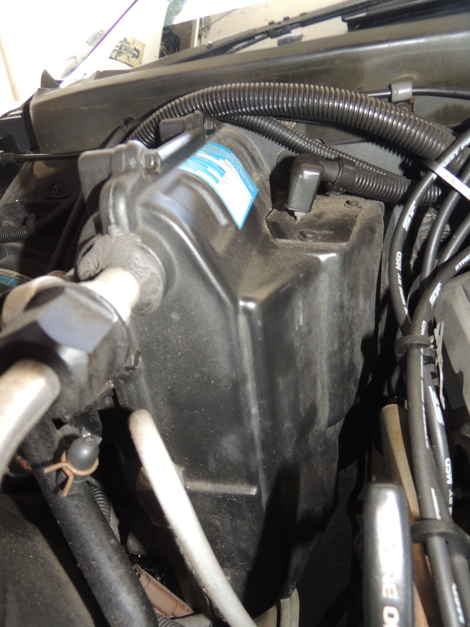

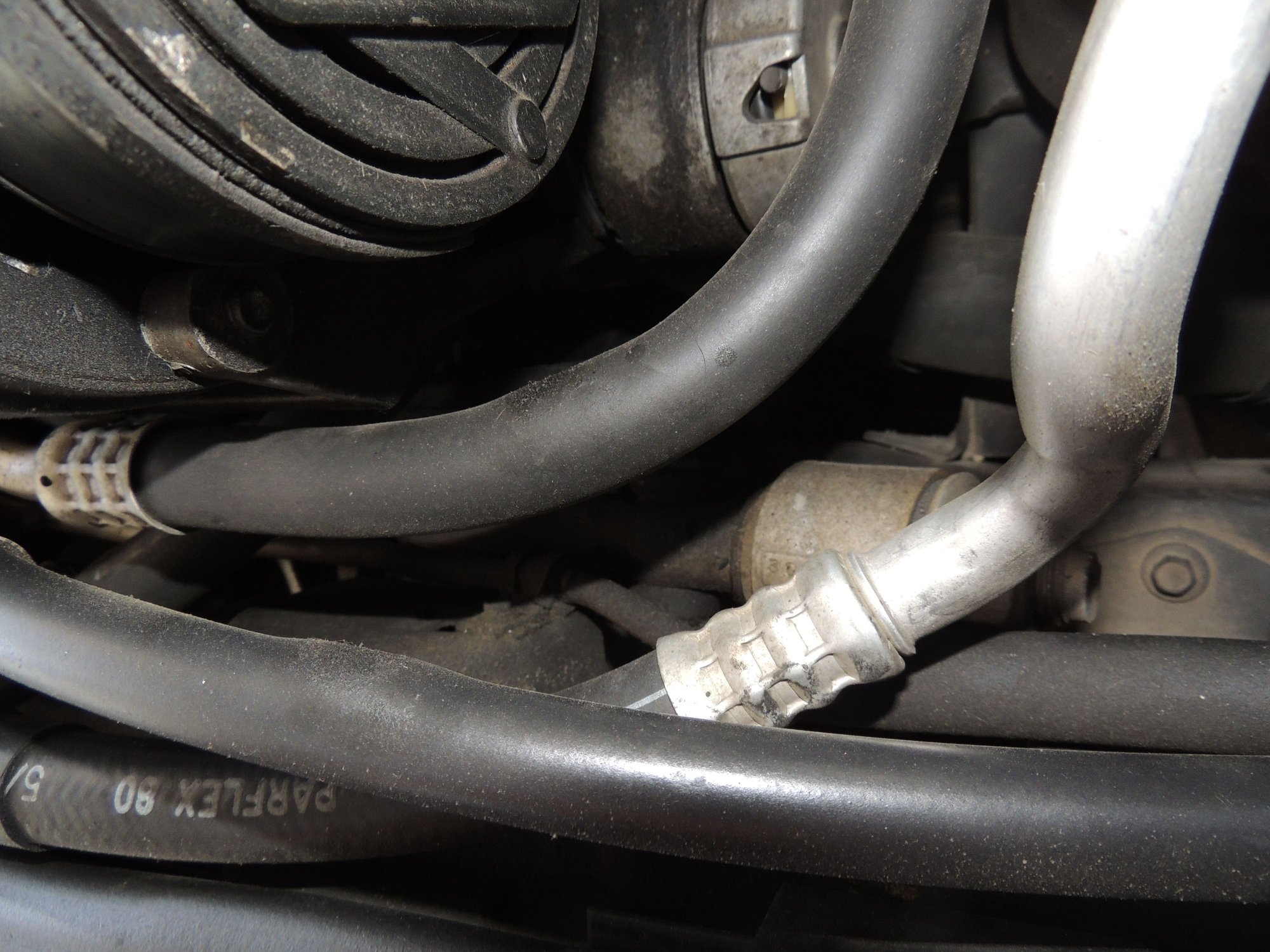

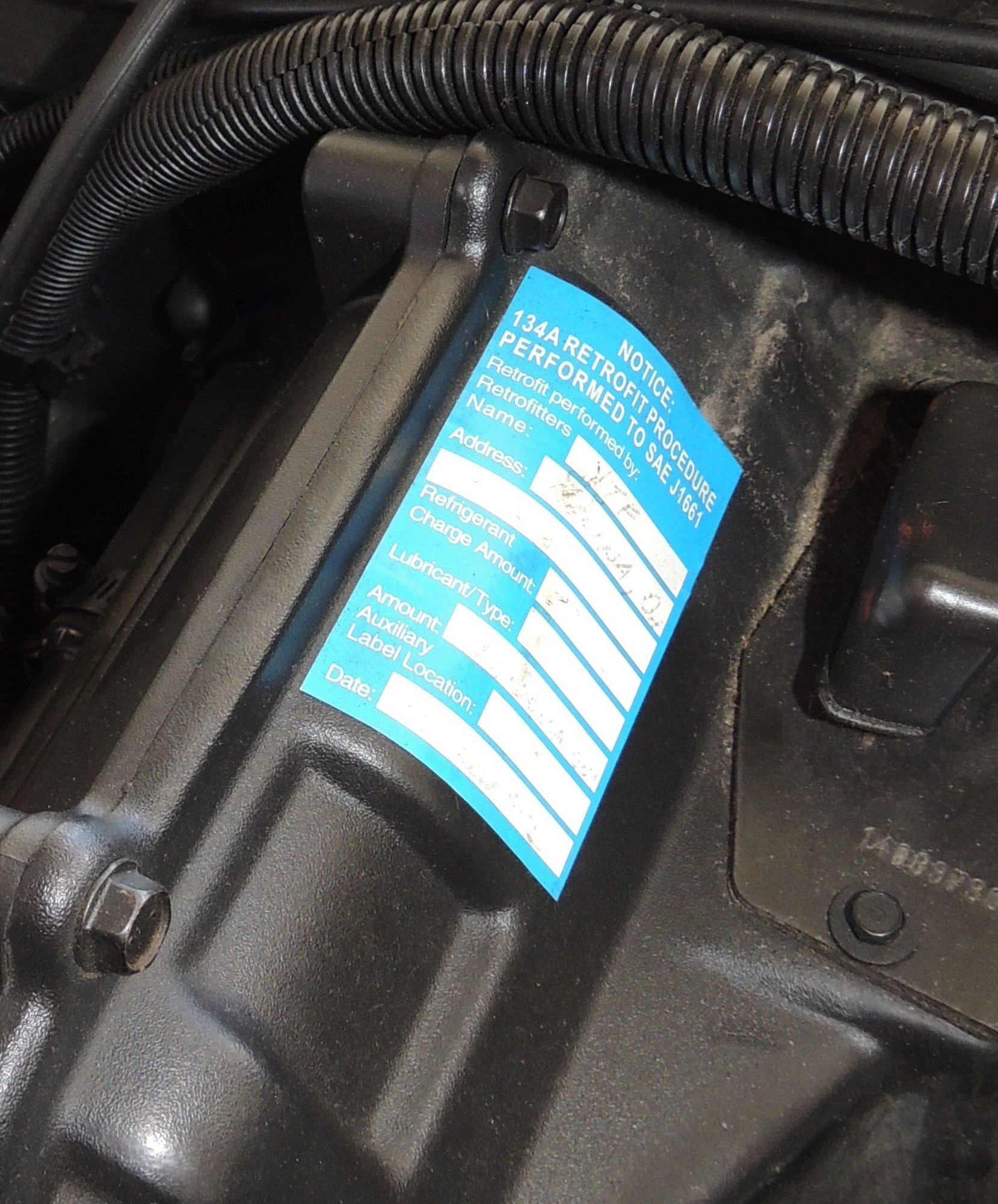

ok maybe not fuel leak - not sure what this is - large black box on passengers side (I have got to get a manual for this car) has metal lines that come out of the bottom and head to the front of the car - the metal lines have a crimped hose under condensor pump(?) the crimp on the top hose is weeping/leaking - but as it does it is carrying with it some other random sludge build up on the cross member - giving it some unique qualities - is this a heater line ? if so is it very difficult to change?
thanks again everyone
Sean
Old Jul 26, 2016 | 12:49 PM
sb66's Avatar
Joined: Jun 2016
Posts: 15
hopefully these work
here are some images of the area and the hosse connection I believe is leaking
thanks sean

I did some more looking - the metal line comes out of the bottom of the box with the blue label travels along the inner fender, transitions to the rubber hose in the pic that is leaking, does a u turn back to the motor and then I lose track of it. definitely creates a unique smell and leaks a fair amount.
Old Jul 27, 2016 | 08:29 PM
The hose with the metal crimp transition to a pipe is part of the air conditioning line.
If that's where the leak is occurring, then that would be the refrigerant oil leaking out. Also your Freon would be coming out and is probably already gone since it's under high pressure. Does the A/C still function properly?
