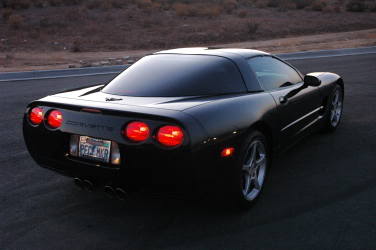

My car makes a very audible wind noise when I travel at 80 mph or above. It mostly comes from the passenger side between the window and the edge of the targa top. Does this happen to any of you? What's the solution?
