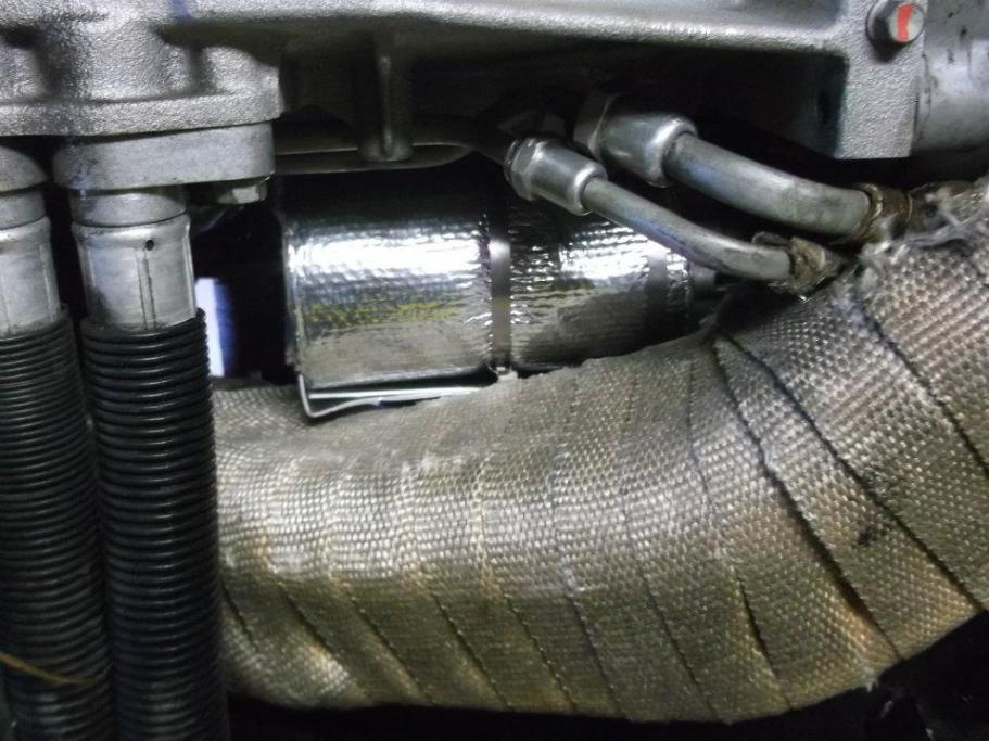

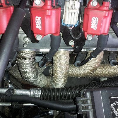

Was having heat soaking issues from the long tubes on the starter so modified the headers, plated and thermo wrapped the starter. Now after romping around and then turning the car off it has no problems starting up up.Supercharged Z06 w/Long Tube mod-z06-wrap.jpg
Supercharged Z06 w/Long Tube mod-wrap-2.jpg
