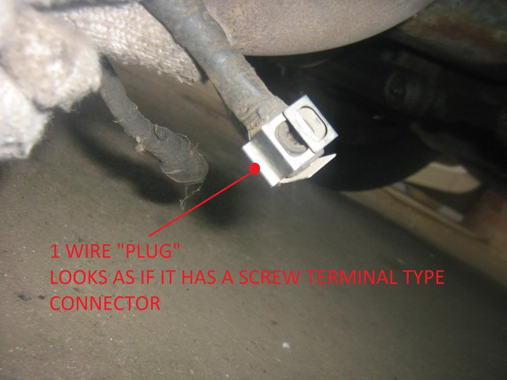

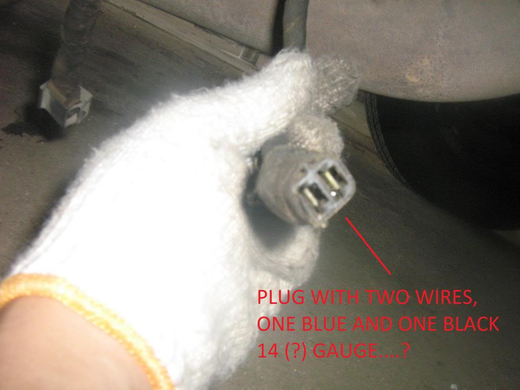

Upon immediate inspection I find a couple of loose plugs/wires. One is a two wire (Black and Blue, maybe 14 gauge plug) and the other is a single wire (Black, I think, that looks as if it has a screw receptor on it).
Pictures of these plugs have been attached to this post. I have no idea what these could be so any input is greatly appreciated.

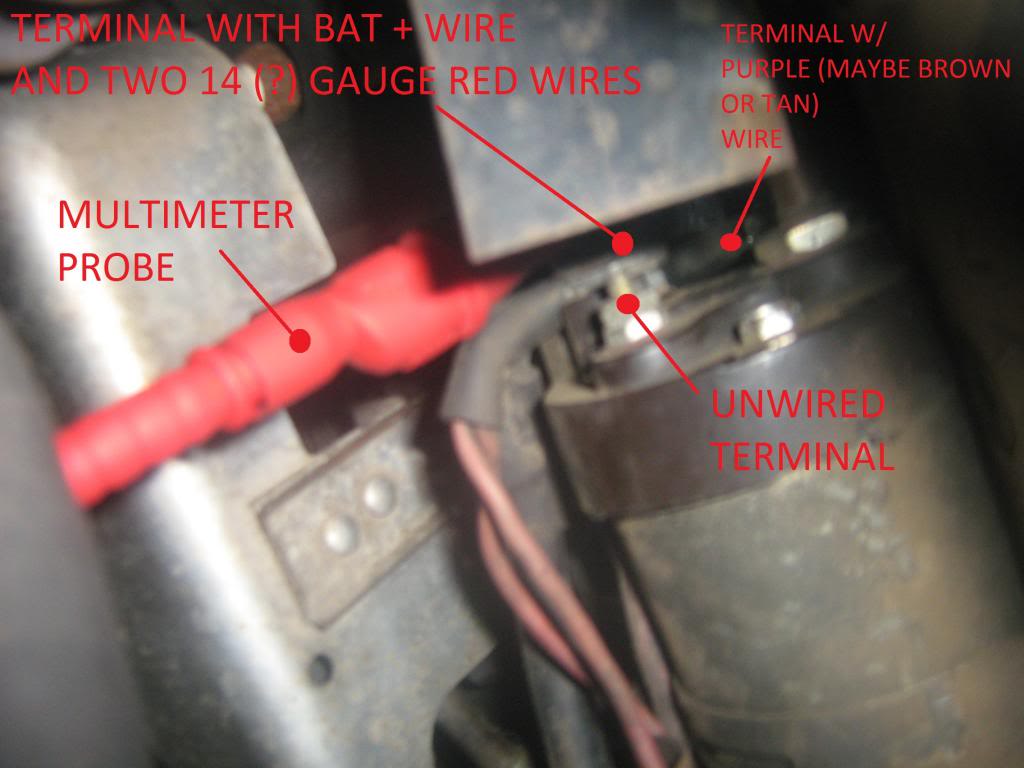

On the starter solenoid I can see the larger terminal with the large batt + and the two red wires connected to it. On the engine side of the solenoid I see a smaller single wire terminal which looks to be tannish in color (could be purple?). There is also another terminal opposite of this terminal (outboard side) that has nothing connected to it. Does this connect to anything?
I have attached a photo of my starter solenoid connection interface. Please forgive the blurriness... I was having a hard time taking the photo on the ground.
I measure continuity of the larger terminal to batt + but no voltage across upon turning the key. So, what are the other two terminals and what type of readings should i get?

Are you saying that you have 12V at the solenoid until you turn the key to Start and it goes to zero? If that's the case then you have a bad connection in that 12V line between the solenoid and the battery or the starter is shorting to ground.
Can't help you on the two connections you pictured. Maybe someone w/ an '82 can chime in. Suspect they might be emissions related. Does the car seem to have the original emissions hardware like cat convertor, etc?
With a good bat, you should have power at all times to the large terminal with the two smaller wires. Be sure bat terminals and both ends of the large cable are clean and connected tightly.
Often times extra connectors are found due to the fact that they make the same loom of wiring for several dif applications. Weather it's an auto or manual, AC or no, and more
options. Keep them in the back or your mind, but let's get 'er started first, eh? ; )
