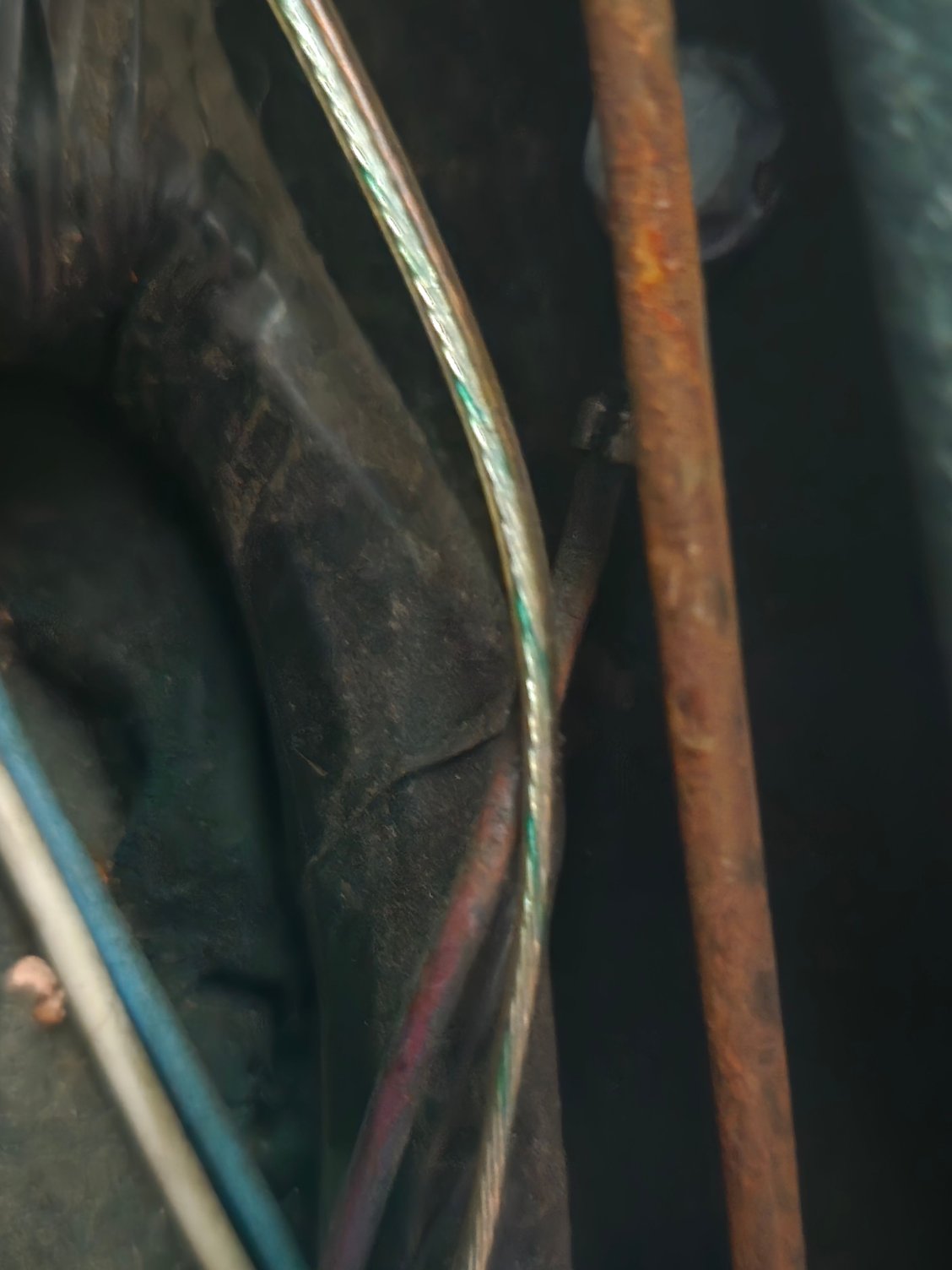

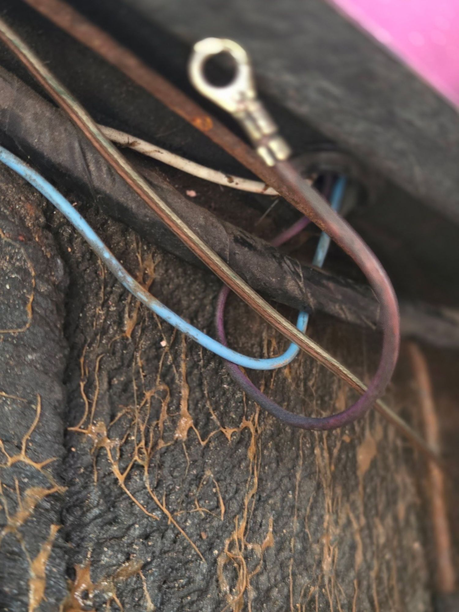

Thanks again for looking into this further for me. I was searching the web for more information regarding my problem and found a very old post that was very helpful. According to this person, During the 1973 model year the door switch design for the alarm was changed from a 3-wire switch to a 2-wire switch. The 3-wire switch-had a black, lt blue, and white wire. The black was the ground wire. After the switch to 2-wire, the black wire was attached to the switch mounting bracket and then grounded on the other end. This left just the lt blue and white wire connected to the switch (this is what I have). The white wire is the ground that activates the alarm relay and the lt blue wire operates the "door ajar" dash light. With that in mind, I went out this morning and removed the switch at the driver's door and touched the blue wire to the mounting bracket and the "door ajar" light came on as it should. I then touched the white wire to the mounting bracket with the alarm switch turned on and the alarm beeped as it should. At this point, I suspected the switch was bad even though my continuity check said it wasn't and moved the switch from the passenger door to the driver's door. The alarm worked again. Still being suspicious, I re-installed the original driver's side switch and the alarm worked great. At this point, the alarm system is working for the hood and both doors and I don't know why. I decided to pull the carpet behind the seats and inspect the wiring. Everything looked OK and I was able to locate the ground wire from each switch mounting bracket. I removed them from their grounding points, cleaned and re-attached. It was a bittersweet moment, I'm glad the system is now working and gained a lot of knowledge about it but did not gain the satisfaction of knowing what the problem was.
Ground wire in background. Drivers interior quarter panel trim removed.
Ground wire in background. Driver's interior quarter panel trim removed.
Ground wire detached and cleaned. Note the blue and white wire coming inside from the alarm switch.
