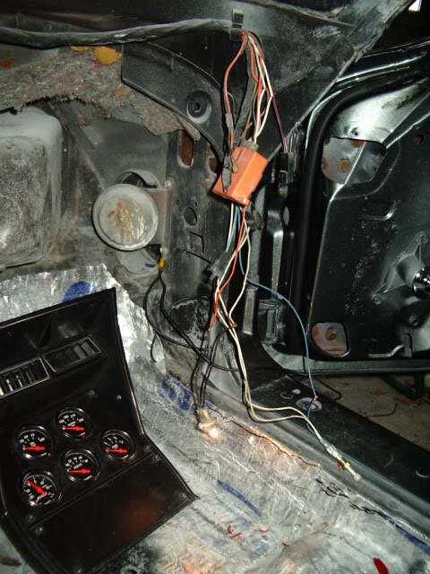

Hi again,
You may still have a problem with the antenna relay or motor but here's a few other things to check:
Do you have a time delay for your courtesy lights? If so the board can go bad and create a draw. The delay module is an orange box behind the passengers side glove box, you can disconnect it and see if the draw goes away.
Other things to check if you have them:
under hood light
spare tire light
glove box light behind the seats
passenger vanity light on the sun visor
Happy hunting,
PG
