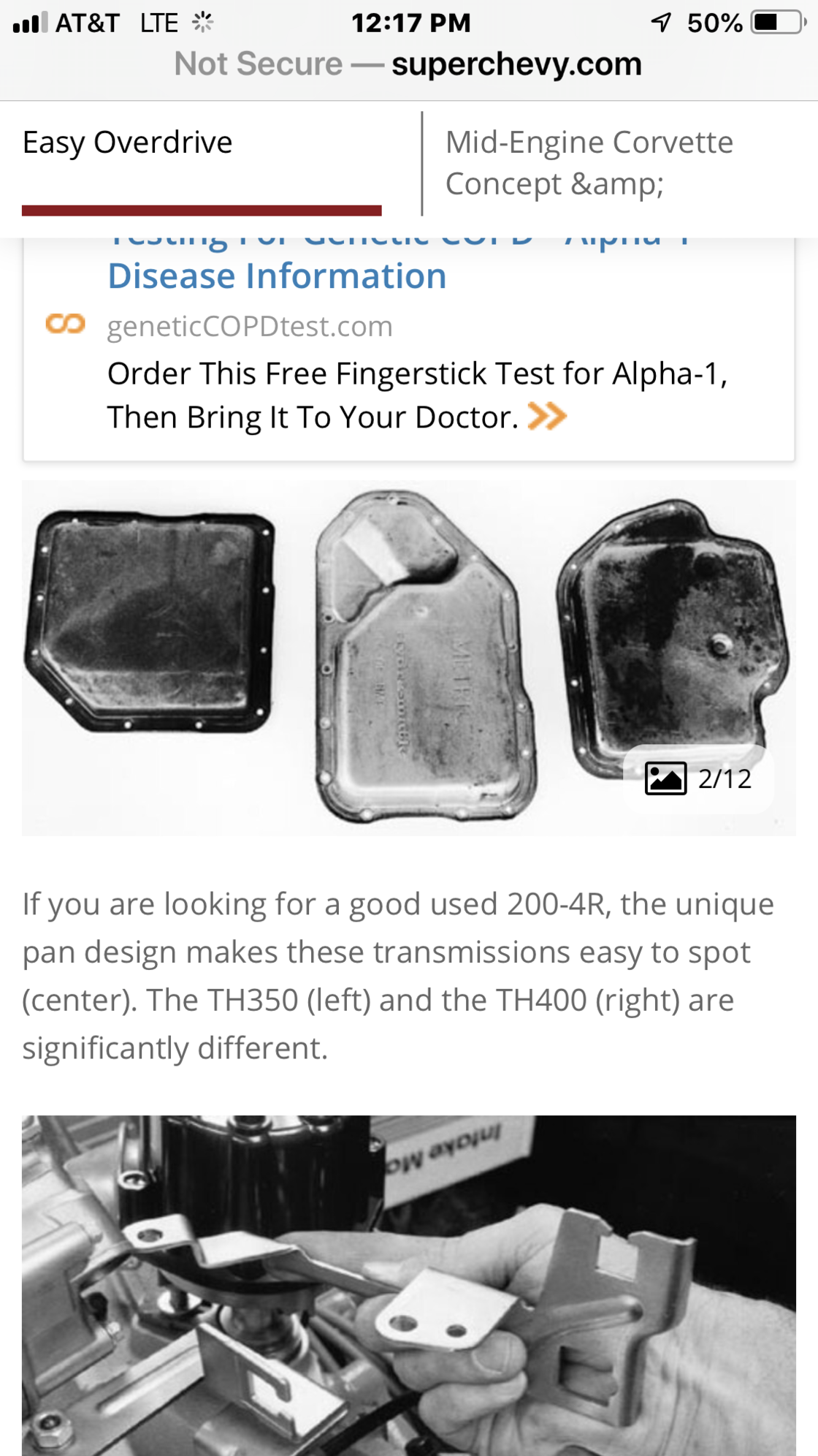

I bought a 1972 vert with an automatic transmission. It has a 350 engine and I assume the original transmission. It has a slight leak around the tail housing seal that needs to be replaced. I have been told that the 72's came with a th350, but I was also told that they came with a th400. How can I tell what I have ?

Easiest way to tell is by looking at the oil pan

That's exactly what I needed !! Many thanks
