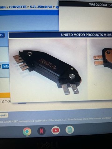

Having another thought about the 7 pin module in the distributor makes me suspicious. It is possible it could do the same thing, It could be old and maybe loose or have bad wires.

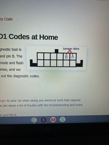

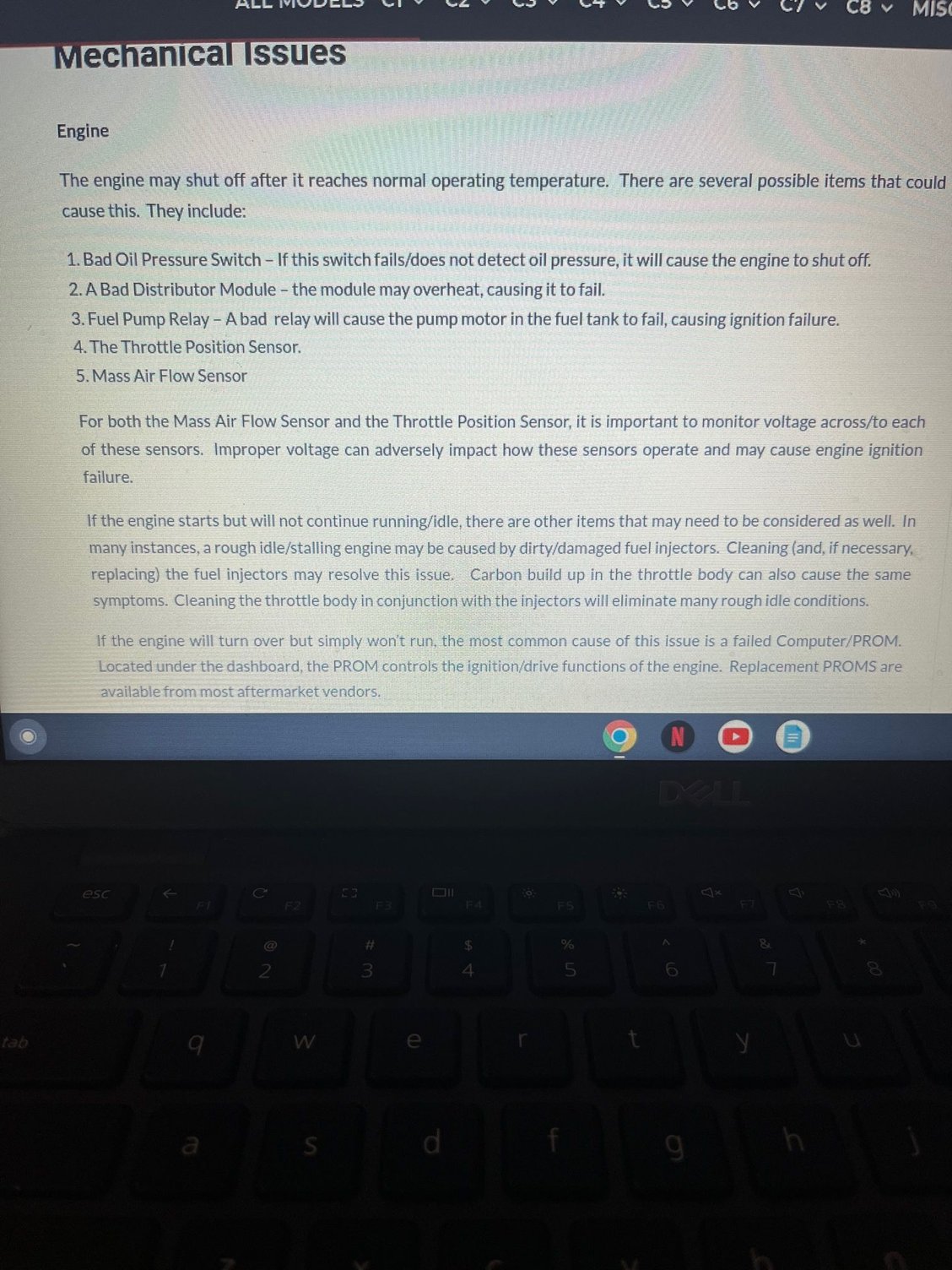

Found some info that might be helpful
