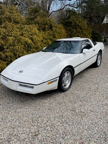

Been almost a year but it finally RUNS.... 79 year old me had some health setbacks but back up and running along with the C4. Bought this last February from the original couple that bought it new in 1988. It looked great and with only 15.000 miles and kept in a heated garage for almost 40 years- it should have.
SO I oiled up the cylinders. changed the plugs, let it sit and then turned by hand after it's five year nap, I drained the foul smelling gas put in some fresh and prepared to start the beast to endear my wife and startle the neighbors!!!!!

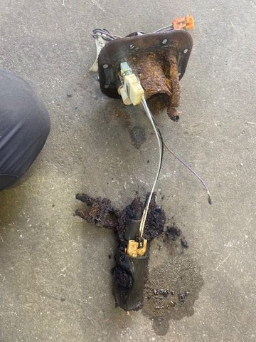

Nothing, NADA, ZIPPO... then I got out the bore scope to peek at the tank...... YIKES... Fuel pump in twisted rusted pieces on floor of fuel tank.... a tank that looked pristine from the outside......
I think my sellers might have forgotten about a few years of storage. One new Tank assy complete with everything and a second new battery it fired to life..... on 6 cylinders. My Chevy knowledge is extensive PRE 1975 took me a while to unravel the mystery of the TPI.... but new injectors and the internet saves the day.... it literally runs like a 15k engine now. To get it on the road it was time for tires...the originals dry rotted off the rims.. So 4 new Azenis and four new calipers...and some Powerstop Rotors and pads and it stops....WELL !!!!!! Drove it about 25 miles last night and No Creaks no Squeaks and drives like a dream.... Not supercar power but plenty for any road use.

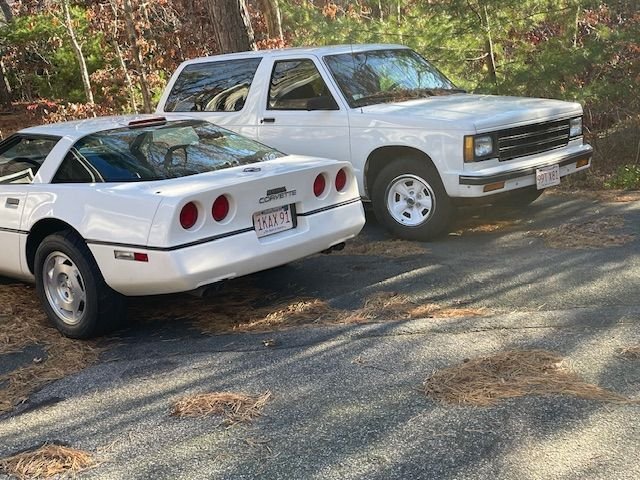

The Blazer has an old school 283 running the GM TB... not everyone's dream car but I like the lines.
Now I have to find a Camaro and an Impala SS to be the local late eighties and early 90's Chevrolet KIng
