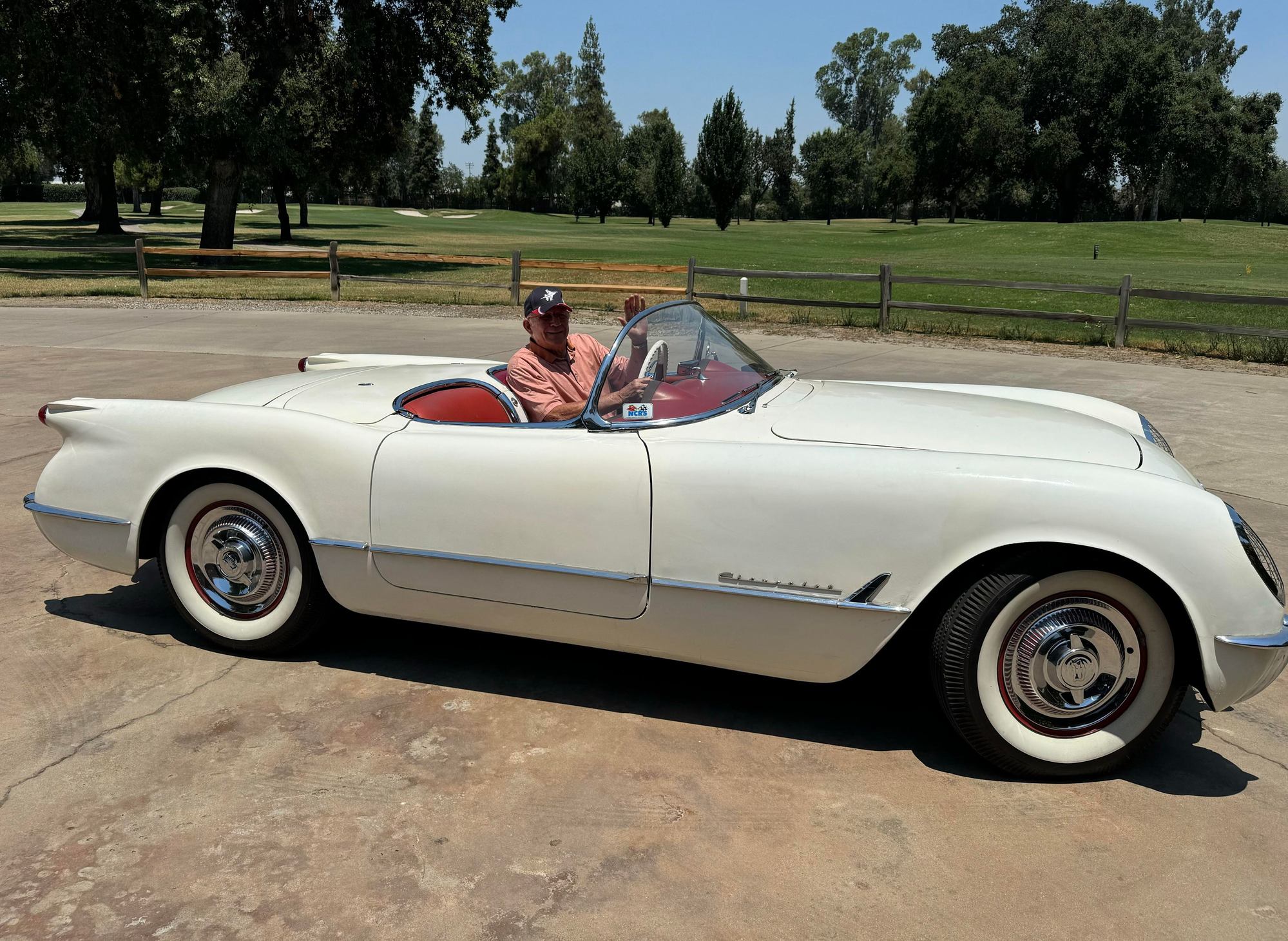

Unhappy 1954 Corvette Slow engine rotation starting problems
1954 Corvette with starting problems:even with a 2nd battery attached as a jumper assist
I am the 2nd owner of a very original 1954 Corvette (# E545002329) with 88,545 very well documented miles that is undrivable due to starting problems.
Engine rotation on start is very slow and labored and rapidly discharges a fully charged 6 volt battery. It won'dt rotate engine fast enough to start.
The engine runs fine if it will start.
The batteries are new and fully charged
I have cleaned all cables, battery posts and grounding areas
I'm a frustrated retired USAF Fighter pilot (not an electrician) who is searching for assistance.

Welcome to the forums. Nice ride, where is your battery located (how long are the battery cables)? Fighter pilot my dream job if it wasen't for bad eyes. Have you thought of using a 8 volt battery? There is an option you can do (we used to do it on older farmalls) where we used a 12volt battery and generator, and 6 volt starter no trounle spinning over you can't run the starter for very long periods. it gets warm. swapping the electrical system over to 12 volt then drop the voltage for the gauges. Maybe an option.
