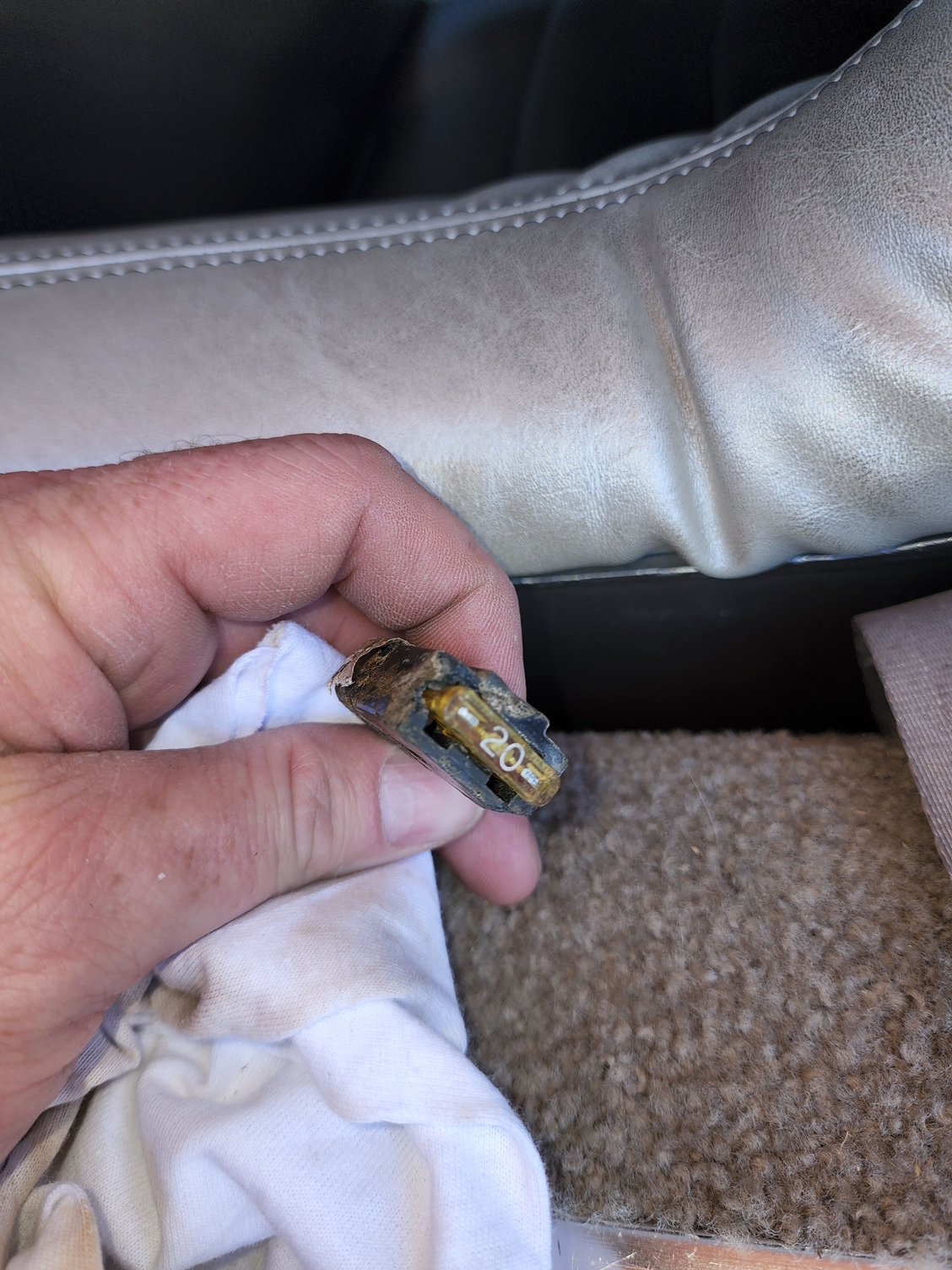

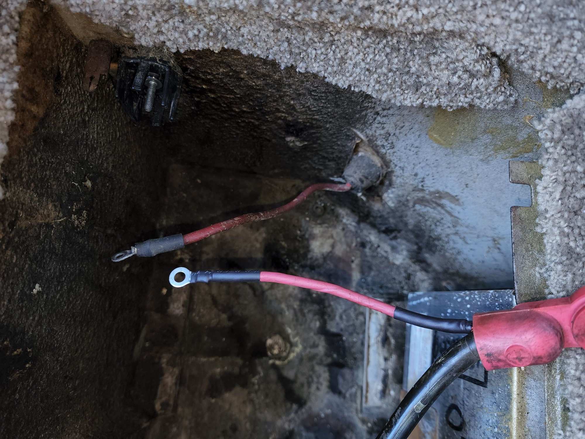

The old junction block that wasn't in too bad of shape. By adding a new one I cleared the free shipping on my online order.

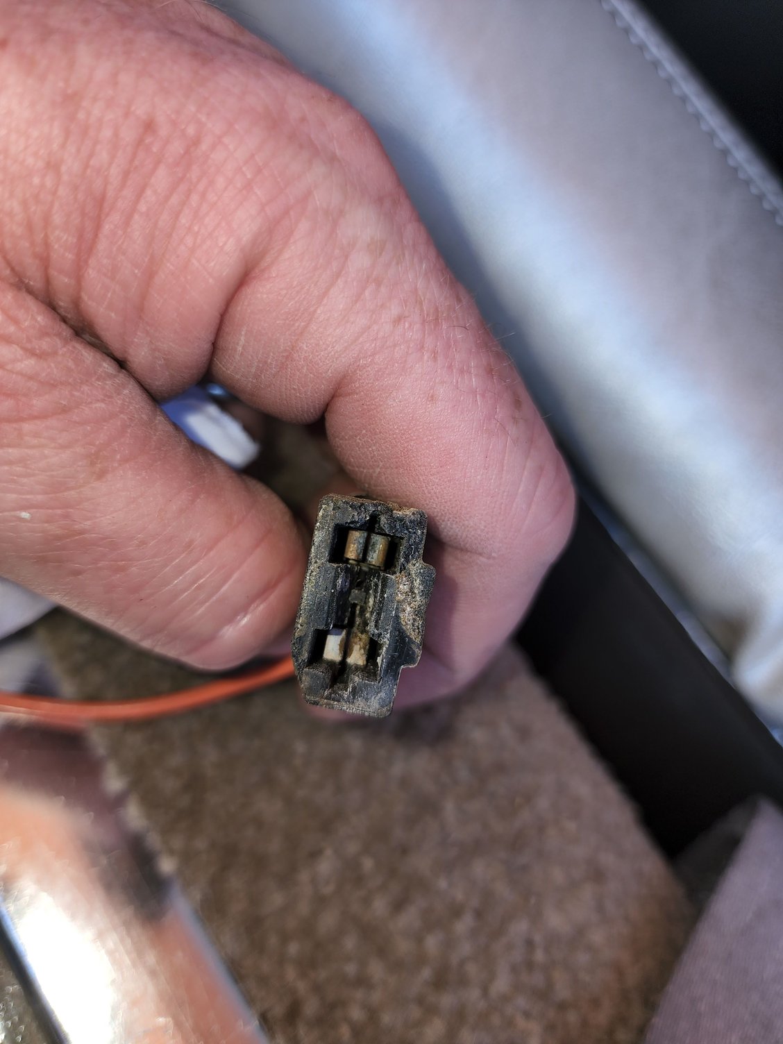

The old ECM plug for the inline fuse.
Old fuse

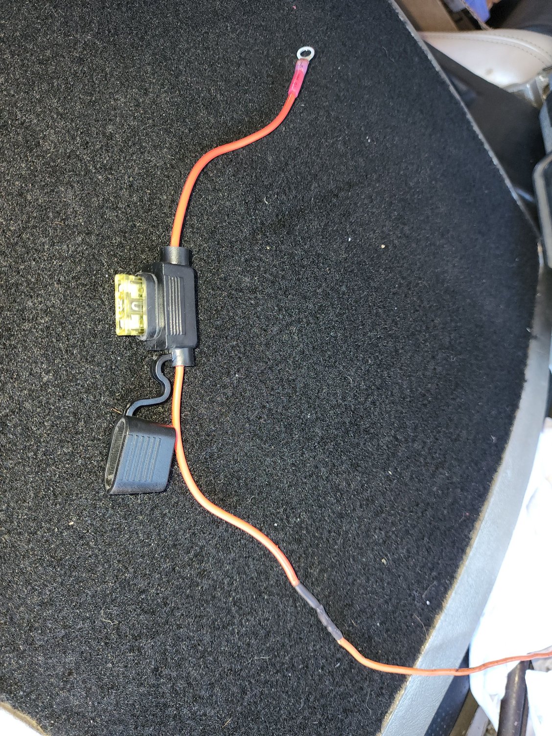

Purchased another inline fuse. I soldered the wires and used heatshrink. Again this is heading to the ECM.

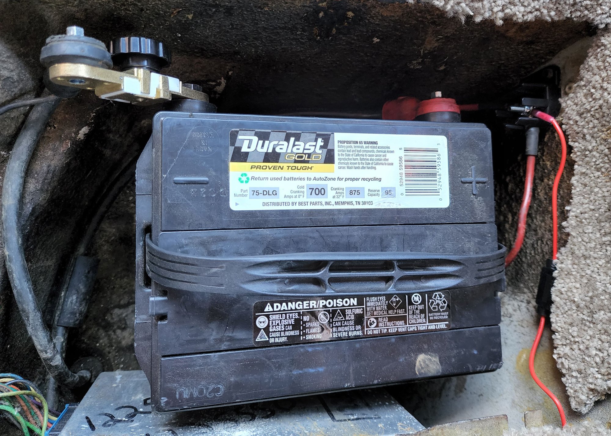

Not perfect but not bad. Starts right up everytime so far now. I need a battery hold down setup. The quick disconnect is a tight fit and I read about a different setup most use. For now I'll leave it on.

Posts: 4,213
In electrical work, new stuff is usually better than cleaned up old stuff so you probably made the right choice. 👍🙂
