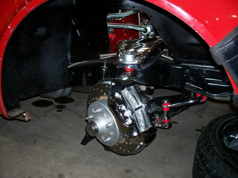

Energy Suspension all the way

Wow! Is that clean? That looks great, and nice touch with the red too.
Are those chrome brake pads? PG
