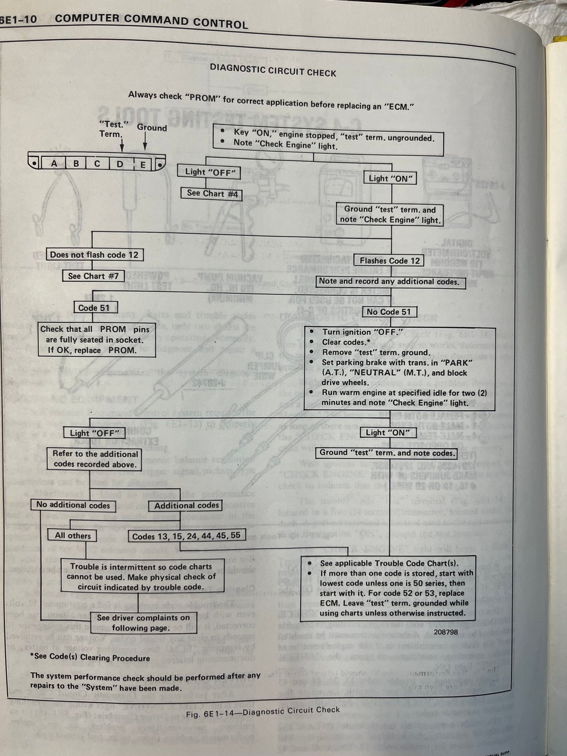

Old Feb 23, 2026 | 09:27 PM
Posts: 979
Here are some printed material from a GM shop manual on disnostics. It should help you reset or figure out the error. If there are no error codes the light should go out.

thomas 77: Thank you so much! I'm sorry for not thanking you sooner. I've been distracted with work stuff, but I'm ready to focus on my car again. I also tried driving it for 50-100 miles to see if the light went off on it's own, but it didn't.
We'll take a look at what you sent and see if we can get that light off!
