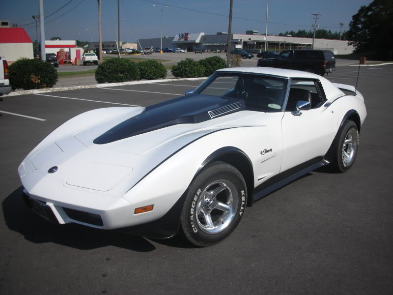

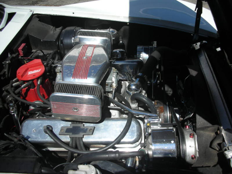

Old Dec 7, 2008 | 01:33 AM
Default RE: Hood Clearance Issue with High Rise Intake
This was under a stock hood. The owner bought an aftermarket hood and I modifiedit just to make it "different". The intake is slightly higher than stock but i'm not sure how much. It's a built 350 with a Holley 750 on it and it runs great.
After hood modification
Dave Mitchell
