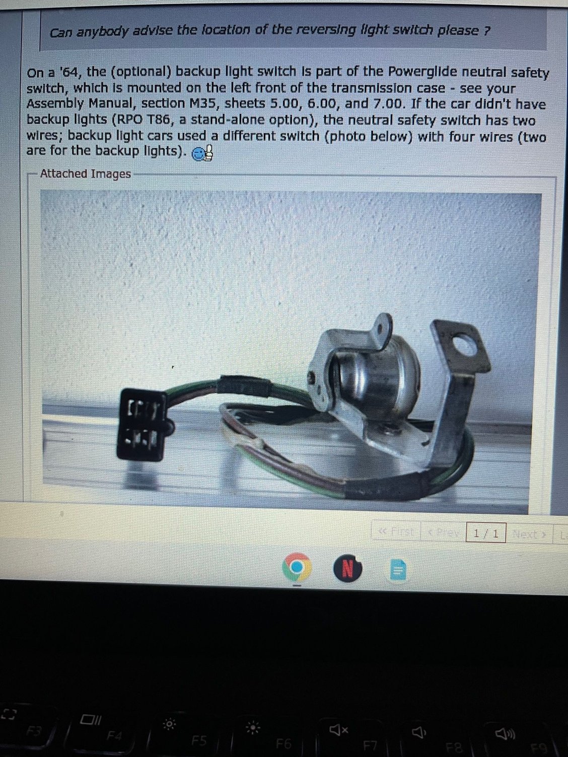

64 327 power glide will not crank checked all power new starter Checked ballast block checked key switch. Can’t find where neutral safety wire goes to transmission

Welcome from Idaho to the forums. I did see a picture of a switch on another forum. Might help?

Default 64 corvette power glide. How to work around neutral safety switch that does not exist
How do I work around no neutral safety switch so e Gail start

You can disconnect the connector by the transmission and install a jumper wire at the connector. That should get it started if the switch is the problem. Be careful because it will start in a selected transmission gear. I would replace that switch soon if it's bad.
